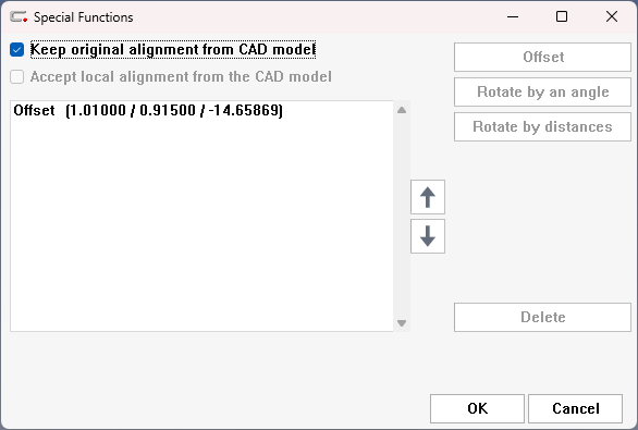

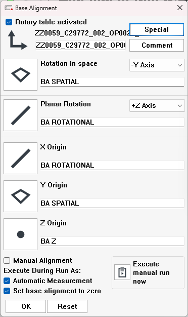

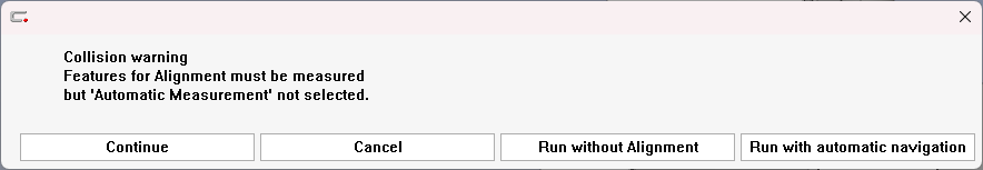

[Sh...] Posted August 15, 2025 Share Posted August 15, 2025 (edited) I use "Keep original alignment from CAD model" in order to keep the Rotary Table on center for Planner purposes only and I have recently had to change multiple programs due to a shortened fixture and I am receiving the following error below in Planner every time I do a CNC run... Anyone seen this before or understand it? After clicking continue, it works fine but it doesn't seem to be going away or I can't figure out which setting to change because the Base Alignment and the rest of the features are all set to Automatic Measurement.. Edited August 15, 2025 Link to comment https://qualityforum.zeiss.com/topic/24207-automatic-measurement/ Share on other sites More sharing options...
[Sh...] Posted August 15, 2025 Author Share Posted August 15, 2025 nevermind folks, must have been having a stroke while programming this, the issue is that Position Points were turned on instead of Clearance Plane in the Run Screen. 2 Link to comment https://qualityforum.zeiss.com/topic/24207-automatic-measurement/#findComment-136829 Share on other sites More sharing options...
