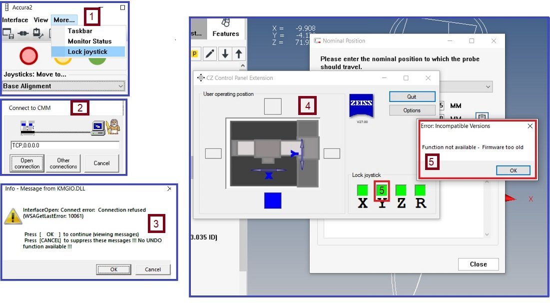

[Ow...] Posted August 19, 2025 Share Posted August 19, 2025 I haven't used this option since upgrading to Calypso 2024 (7.8) back in January so, it may be related to it? As the numerical illustration describes, when trying to lock the Y axis, it produces these errors in the order shown. Anybody every seen this happen? Until now, I've locked the joysticks with no problems for at least 20 years. Link to comment https://qualityforum.zeiss.com/topic/24245-lock-joystick-error/ Share on other sites More sharing options...
[Ke...] Posted August 19, 2025 Share Posted August 19, 2025 I'll be honest, I have never tried to lock the joystick axis through the software, I've always done so through the menu on the joystick box. But based on the message, I would check the firmware revision of the CMM (easiest way is through the error report window in the "extras" menu, though if needed I can describe how to do it via the joystick box as long as it is a modern version with a screen) and compare that against the supported firmware in the release notes from the Calypso Downloads on the portal. 1 Link to comment https://qualityforum.zeiss.com/topic/24245-lock-joystick-error/#findComment-136983 Share on other sites More sharing options...

[na...] Posted August 20, 2025 Share Posted August 20, 2025 Please sign in to view this quote. On step 2, check the CMM's IP address, it is probably TCP,192.4.1.200 Link to comment https://qualityforum.zeiss.com/topic/24245-lock-joystick-error/#findComment-137031 Share on other sites More sharing options...
