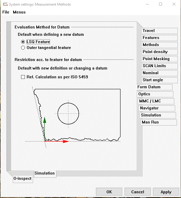

[Cl...] Posted August 22, 2025 Share Posted August 22, 2025 I think I remember seeing a post not long ago talking about the difference between two alignments using the exact Datum's, as in this instance. I thought it had something to do with Evaluation Method for Datum - LSQ Feature Outer tangential feature ISO 5459 Link to comment https://qualityforum.zeiss.com/topic/24289-make-this-make-sense/#findComment-137271 Share on other sites More sharing options...

[Ro...] Posted August 26, 2025 Share Posted August 26, 2025 Please sign in to view this quote. When there is a position callout that is not fully constrained, a sub alignment should not be used in the position characteristic's evaluation. If you look below the sub alignment's name you see (Base Alignment) which means any open slot gets automatically filled in by what was used in the base alignment, making it fully constrained. That's why you see the same result. Attached a Zeiss document explaining this. If the print callout is only to -AB- then you must only enter datums -A- and -B- in the position characteristic. No need for the 3DLine. Also, when you create your base alignment, the features are evaluated as LSQ. Which is what you want. It's the most stable, repeatable evaluation. When you enter your features in the position characteristic, they should be evaluated as Outer Tangential for Planes and Max Inscribe for ID's and Min Circumscribe for OD's. Hence why you would see the difference. Align_vs_Datum_Ref_Frame.pdf 3 Link to comment https://qualityforum.zeiss.com/topic/24289-make-this-make-sense/#findComment-137491 Share on other sites More sharing options...
