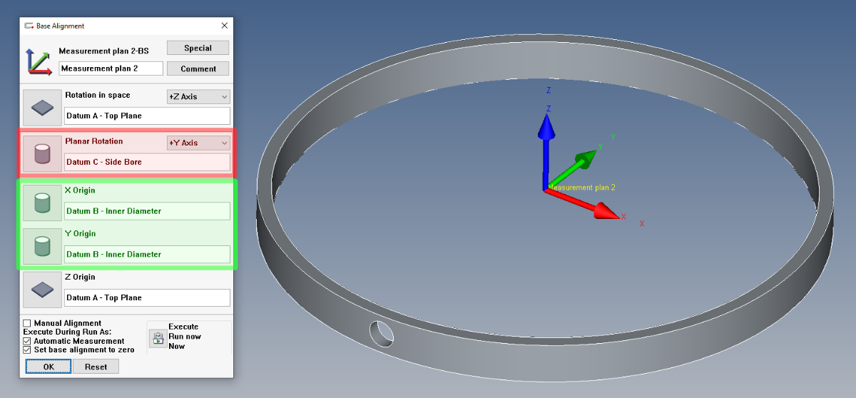

Popular Post [Dr...] Posted August 27, 2025 Popular Post Share Posted August 27, 2025 Good points brought up by Tom & Martin, and I agree that you can generally use cylinders in a BA without a second thought. To give another example where you wouldn't want to, consider the example below. The X/Y Origin could be taken as a circle or as a cylinder without significantly affecting its role in the BA. The Planar Rotation, however, should not be taken as a cylinder. Doing so would cause its "axis length" to be only the thickness of the part rather than the distance from the part center to the bore, significantly impacting repeatability in a way that might not be apparent to someone unfamiliar with how Calypso constrains degrees of freedom. 6 Link to comment https://qualityforum.zeiss.com/topic/24325-cylinders-in-base-alignment/#findComment-137529 Share on other sites More sharing options...
[Ji...] Posted August 27, 2025 Author Share Posted August 27, 2025 Thanks for the answers. Did something change in the newer versions of Calypso or did people start using them and find they worked better than a circle. I only have one part that we have to use a cylinder in Planar rotation. That is a fairly long cylinder and controls the functionality of the part. We use circles on the hundreds of other parts for planar rotation. The X and Y assuming you are probing in Z direction is the one I was concerned with. Thank you all for clarifying this. Link to comment https://qualityforum.zeiss.com/topic/24325-cylinders-in-base-alignment/#findComment-137569 Share on other sites More sharing options...
