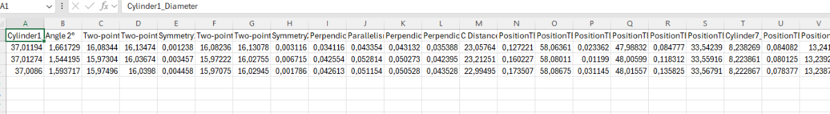

[To...] Posted August 27, 2025 Share Posted August 27, 2025 Recently we updated all three of our CMMs to Calypso 2024, but suddenly one of them starts outputting an excel file with the results in it. If we run the same program on the other CMMs it does not output this excel file, so I believe it is a setting on only this machine which is suddenly active. The excel file has the name of the Inspection plan and is updated with a new result each time the program is executed. Why has it started doing so? And where do I turn it off. Link to comment https://qualityforum.zeiss.com/topic/24327-outputting-excel-file-after-update/ Share on other sites More sharing options...
[He...] Posted August 27, 2025 Share Posted August 27, 2025 It happened to us too; apparently, it's been like this since Calypso 2024. This can't be disabled via a setting in this Calypso version. The following appears to be installed during installation: C:\Program Files\Zeiss\CALYPSO 7.8\bin\Table2Excel\Table2Excel.exe This is responsible for always creating an Excel merge file. Simply rename the file, and nothing will be created, and no error message will appear. Link to comment https://qualityforum.zeiss.com/topic/24327-outputting-excel-file-after-update/#findComment-137509 Share on other sites More sharing options...

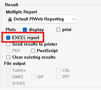

[Ma...] Posted August 27, 2025 Share Posted August 27, 2025 Can not be this turned off in section of export results? There are options for storing measured points, qdas and others. Link to comment https://qualityforum.zeiss.com/topic/24327-outputting-excel-file-after-update/#findComment-137511 Share on other sites More sharing options...
[Sv...] Posted August 27, 2025 Share Posted August 27, 2025 Wie Martin sagt gibt es unter Vorbereiten-> Ergebnisse auf Datei ( heißt glaub so. Ich habe 2025 da heißt es anders)-> dort kann gewählt werden was exportiert wird. Ich glaube das da auch der Excel Bericht dabei ist. Oder mal bei CNC-> Startwerte vorbelegen schauen. Link to comment https://qualityforum.zeiss.com/topic/24327-outputting-excel-file-after-update/#findComment-137513 Share on other sites More sharing options...

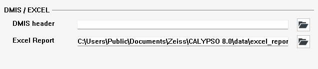

[To...] Posted September 30, 2025 Author Share Posted September 30, 2025 Please sign in to view this quote. Is it in anyway possible that tabel files and excel files are in two different folders? Link to comment https://qualityforum.zeiss.com/topic/24327-outputting-excel-file-after-update/#findComment-139187 Share on other sites More sharing options...
[Lu...] Posted September 30, 2025 Share Posted September 30, 2025 Please sign in to view this quote. By default, both these files go to the "Default Path for Results Files" specified in Extras > Settings > Environment > Paths. However, you can change the path for table files at Resources > Name for Output Files. Link to comment https://qualityforum.zeiss.com/topic/24327-outputting-excel-file-after-update/#findComment-139253 Share on other sites More sharing options...
[To...] Posted October 3, 2025 Author Share Posted October 3, 2025 As I see it, that is not an option to set table file in a different folder than the excel report. My conclusion is that, if possible. I could make a button of the Pi-Web report that measurement results should be exported to excel. Link to comment https://qualityforum.zeiss.com/topic/24327-outputting-excel-file-after-update/#findComment-139465 Share on other sites More sharing options...
