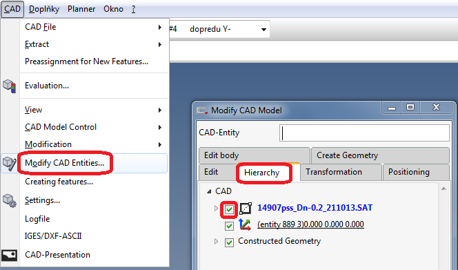

[Ma...] Posted August 27, 2025 Share Posted August 27, 2025 Hallo zusammen, sobald ich das CAD Model anklicke verschwindet es aus Calypso. Hat jemand eine Idee was das sein kann? Vielen Dank im Voraus. Beste Grüße Manuel Link to comment https://qualityforum.zeiss.com/topic/24329-cad-verschwindet/ Share on other sites More sharing options...
[Ma...] Posted August 27, 2025 Share Posted August 27, 2025 (edited) Hi, I have never experienced this behaviour. There are common troubleshooting: check nvidia 3D settings preset: should be Autodesk Motion Builder - compatible restart Calypso / pc replace model make new program Also you can possibly have unchecked visibility of CAD model in hierarchy. Providing as much information as you can can help with solution - such as full version of Calypso. Edited August 27, 2025 1 Link to comment https://qualityforum.zeiss.com/topic/24329-cad-verschwindet/#findComment-137501 Share on other sites More sharing options...
[Ma...] Posted August 27, 2025 Author Share Posted August 27, 2025 Danke für die Rückmeldung, habe das CAD neu geladen. Funktioniert jetzt. Danke 1 Link to comment https://qualityforum.zeiss.com/topic/24329-cad-verschwindet/#findComment-137527 Share on other sites More sharing options...
