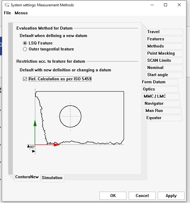

[FL...] Posted August 27, 2025 Share Posted August 27, 2025 I was wondering what these settings should be, none of our machines are the same. What will this affect? We are running 2023 and 2024 Calypso 1 Link to comment https://qualityforum.zeiss.com/topic/24337-calypso-settings/ Share on other sites More sharing options...

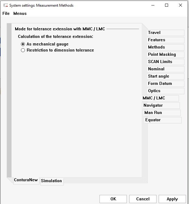

[Ma...] Posted August 27, 2025 Share Posted August 27, 2025 It depends on what norms you are running - for ISO - it's LSQ ( gauss ) and unchecked ISO 5459. For ASME - i believe it's Outer tangential teature and checked ISO 5459. I believe you know difference between LSQ and Outer tangential. ISO 5459 will use exact 90° and not real intersection. For MMC - one is allowing you to grow your tolerance ignoring feature dimension out of spec - other will set you ZERO bonus for feature out of spec. I hope someone will correct me if i am wrong. Link to comment https://qualityforum.zeiss.com/topic/24337-calypso-settings/#findComment-137537 Share on other sites More sharing options...
[To...] Posted August 27, 2025 Share Posted August 27, 2025 (edited) I believe when set as "mechanical gage", it still adds bonus to the tolerance. My interpretation is that you're looking for correlation with a production floor measurement. For example, in some high quantity production environments, an operator has 2 sets of gages. One, is a functional fit position gage and the other is a set of go / no-go gages for hole size. If the holes are oversize, the functional gage passes, but will fail when the sizes are checked. When Calypso is set to mechanical gage, the report will match what happens on the floor. This is just my own interpretation for having this option. I think for most users, it would be best to set to "Restrict to dimensional tolerance". Please sign in to view this username. To comply with ASME, the evaluation for new datum features should also be set to Outer Tangential Element. If you are using the BETA GDT option, the software automatically applies these evaluations. Edited August 27, 2025 3 Link to comment https://qualityforum.zeiss.com/topic/24337-calypso-settings/#findComment-137541 Share on other sites More sharing options...
[na...] Posted August 28, 2025 Share Posted August 28, 2025 And don't forget to restart Calypso or re-initialize CMM connection to apply MMC/LMC calculation mode. Link to comment https://qualityforum.zeiss.com/topic/24337-calypso-settings/#findComment-137627 Share on other sites More sharing options...

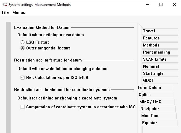

[FL...] Posted September 23, 2025 Author Share Posted September 23, 2025 I noticed in 2025 there is an extra check box in the form datum settings, what should these be set to for ASME Link to comment https://qualityforum.zeiss.com/topic/24337-calypso-settings/#findComment-138773 Share on other sites More sharing options...
[FL...] Posted September 24, 2025 Author Share Posted September 24, 2025 I have ASME selected for GD&T, but I’m not sure what I need selected for Form Datum, any help would be appreciated Thanks Link to comment https://qualityforum.zeiss.com/topic/24337-calypso-settings/#findComment-138839 Share on other sites More sharing options...
[To...] Posted September 24, 2025 Share Posted September 24, 2025 (edited) Please sign in to view this username. If you're using the BETA GD&T, which I believe is the default on new versions of Calypso, I don't believe the form datum or ISO5459 settings matter. They apply to the old way of gd&t. The light bulb in the GD&T window confirms how it is being evaluated. Edited September 24, 2025 Link to comment https://qualityforum.zeiss.com/topic/24337-calypso-settings/#findComment-138863 Share on other sites More sharing options...
[FL...] Posted September 24, 2025 Author Share Posted September 24, 2025 I’m using 2025 Calypso Link to comment https://qualityforum.zeiss.com/topic/24337-calypso-settings/#findComment-138865 Share on other sites More sharing options...
[Ri...] Posted September 24, 2025 Share Posted September 24, 2025 If you are using either the ISO or ASME standard 5459 will automatically be applied. Link to comment https://qualityforum.zeiss.com/topic/24337-calypso-settings/#findComment-138875 Share on other sites More sharing options...
