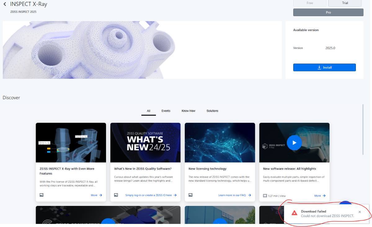

[La...] Posted August 27, 2025 Share Posted August 27, 2025 Hello, wenn i click on Install i receive this error like showed in the Picture. can somebody tell me what i get wrong ? Laura Link to comment https://qualityforum.zeiss.com/topic/24339-i-could-not-download-zeiss-inspect/ Share on other sites More sharing options...
[Na...] Posted August 27, 2025 Share Posted August 27, 2025 Hello Laura, please check if the proxy settings are correct in the settings and if the suite is allowed to communicate following this list: ZEISS Quality Tech Guide You can also download the software installer manually from portal.zeiss.com -> Download Center Nanno Link to comment https://qualityforum.zeiss.com/topic/24339-i-could-not-download-zeiss-inspect/#findComment-137555 Share on other sites More sharing options...
