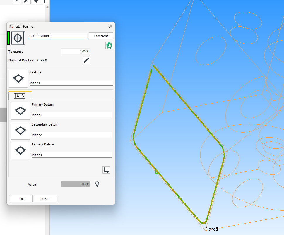

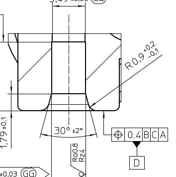

[Mi...] Posted August 27, 2025 Share Posted August 27, 2025 I have a callout for the TP of a plane back to BCA How do I do a plane TP. Never had to do this and I'm kind of stumped. Any help is appreciated.. Link to comment https://qualityforum.zeiss.com/topic/24343-tp-of-plane/ Share on other sites More sharing options...
[Ha...] Posted August 27, 2025 Share Posted August 27, 2025 You can enter the plane as the toleranced feature directly into the position characteristic. Link to comment https://qualityforum.zeiss.com/topic/24343-tp-of-plane/#findComment-137615 Share on other sites More sharing options...
[Ma...] Posted August 28, 2025 Share Posted August 28, 2025 We have some planes and for our measurement we are using surface profile. It should give us same number on Bilateral, one result Link to comment https://qualityforum.zeiss.com/topic/24343-tp-of-plane/#findComment-137625 Share on other sites More sharing options...
[Mi...] Posted August 28, 2025 Author Share Posted August 28, 2025 Thanks All. I'm going to mess around with it today. I also have talked to the Eng and we agreed it might be better suited for a profile callout. We shall see Link to comment https://qualityforum.zeiss.com/topic/24343-tp-of-plane/#findComment-137631 Share on other sites More sharing options...
