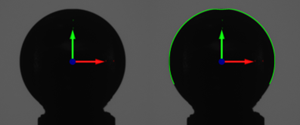

Recently, in our lab, we had a job involving silicon carbide — a highly abrasive material. A programmer, unfamiliar with its properties, began scanning the surface with a silicon nitride stylus. By the time I caught on, multiple scans had already been completed. To the naked eye, the stylus looked fine. But when we pulled it under a microscope, a flat spot was immediately visible. The lesson? Styli wear is real, and it can happen faster than you think — even when you can’t see it.
I didn't intend to toot my own horn with this post. But I made a LinkedIn article with the full story. Ultimately, the goal is to use this article and RCCA to push for the purchase of more diamond styli 😁

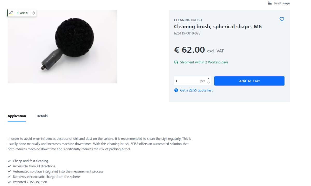

A little while ago, I heard about a new automated cleaning brush that ZEISS was releasing. I couldn't find it available in the United States, but it appears to be available in other countries. But this looks more focused on cleaning a stylus, and it would not remove aluminum buildup.

The one thing to keep in mind, is that the deviations you see graphed are of the reference sphere, not the probe.  So you need to invert the positive/negative areas you see on the graph so to speak.  Kinda like this in my crude drawing.
