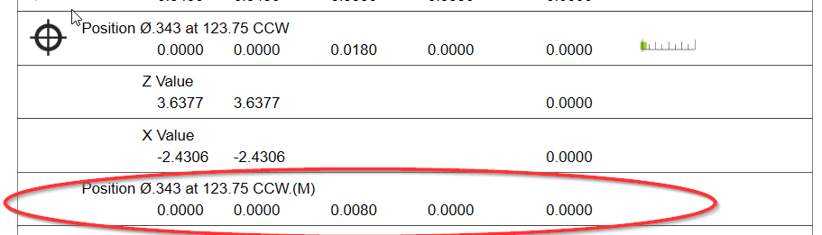

[Pa...] Posted August 28, 2025 Share Posted August 28, 2025 I very recently saw a method for removing the (M) line from a PiWeb report. Can't find what I saw though. Anyone have an answer handy? Link to comment https://qualityforum.zeiss.com/topic/24351-mmc-reporting/ Share on other sites More sharing options...
[Ma...] Posted August 28, 2025 Share Posted August 28, 2025 Here you go 1 Link to comment https://qualityforum.zeiss.com/topic/24351-mmc-reporting/#findComment-137677 Share on other sites More sharing options...
[Za...] Posted September 16, 2025 Share Posted September 16, 2025 Here is a Knowledge Base Article on the topic: https://portal.zeiss.com/knowledge-base?id=458620 Link to comment https://qualityforum.zeiss.com/topic/24351-mmc-reporting/#findComment-138503 Share on other sites More sharing options...
[Ri...] Posted September 17, 2025 Share Posted September 17, 2025 (edited) The .M/.L, and now the diameter if MMC/MMB is used needs to have an option to turn off. Edit: Also, please allow the removal of the name of the SIMREQ as well. Edited September 17, 2025 1 Link to comment https://qualityforum.zeiss.com/topic/24351-mmc-reporting/#findComment-138537 Share on other sites More sharing options...
