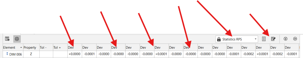

Display/ export data across all stages in one table
Hello all, is there a way to display dimensions from all stages in one table? For example, the dimensions below are for the initial stage, I have many other stages, would like to know if there is a way to get all of the dimensions across stages to all be encompassed within one table. This would make a nice report page, and would definitely make export easier, to utilize in excel, all in one export.
Any help appreciated, == as always

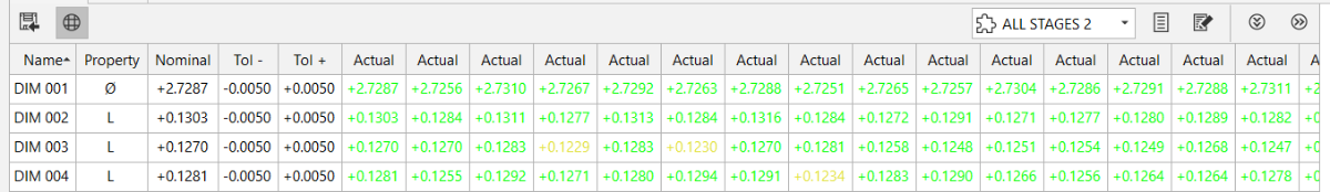

 You are going to have to modify the "Statistics Overview" Template and then save it as your own. It requires some tinkering, but with a single click I can export hundreds of stages of data into one Excel file at once.
  • Like! 1

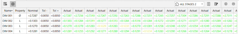

 It's not too complicated. Go to one of your project files that has multiple stages with all your dimensions. Now click to show your table, and from the template drop down select "Statistics RPS" This is one of the stock templates. Click the "Edit" button to the right. This creates a copy of the stock template that you can edit for your own needs. In "Edit" mode, you can right click the cells, and select edit. A new box will appear, where you will see the expressions and or functions that identify what appears in the cell. You can edit the formatting too, and add colors based on the results. You can add columns, delete columns, add rows, delete rows. Once you have it like you want, save your template with whatever name you want. Add the custom template to your "add ons" by clicking on "Manage Templates" at the bottom of your template drop down menu. You are going to have to play around with it to get a feel for how it works. Once you save the custom template to your "add ons" it will be available in every project file from that point forward as an option under "templates".
Edited
STATISTICS RPS

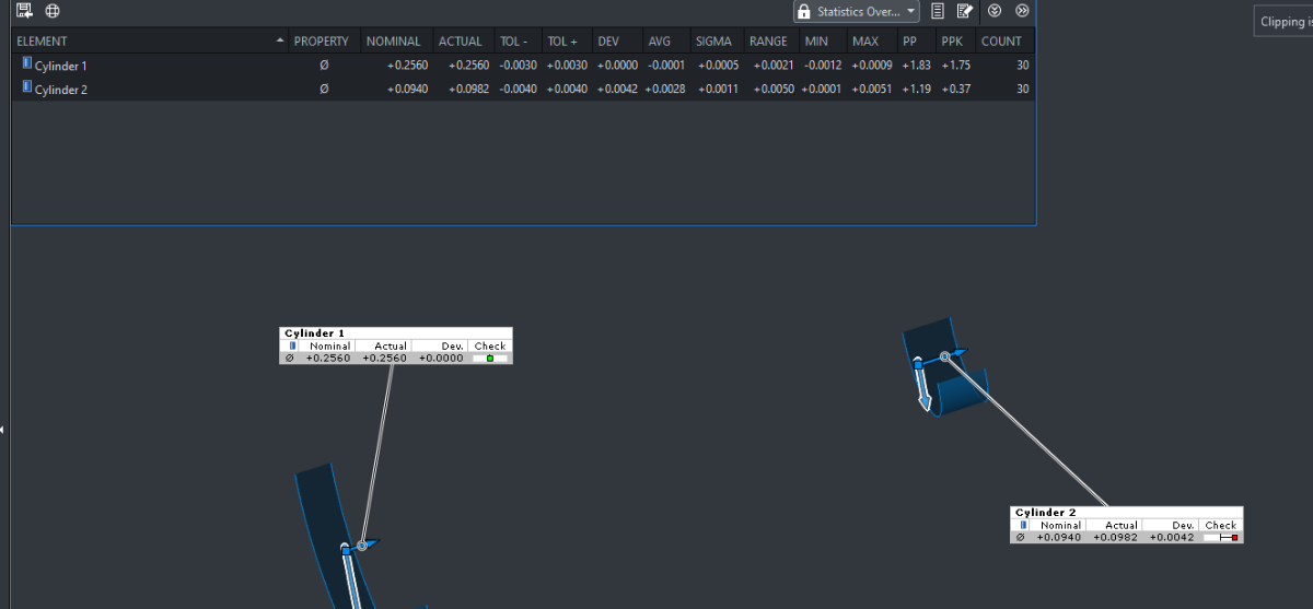

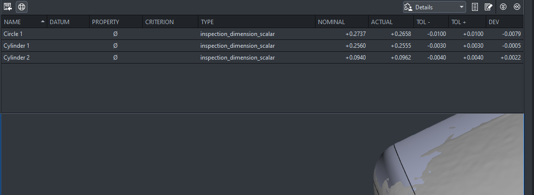

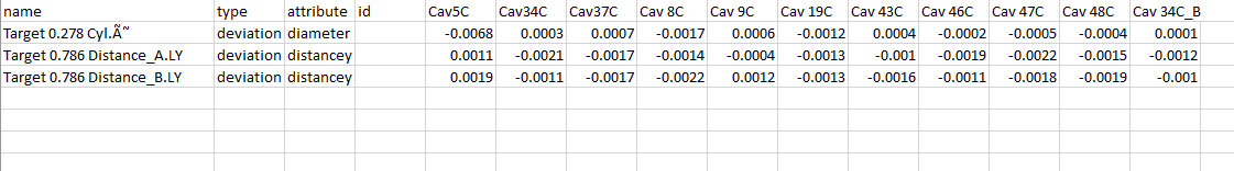

So, trying the "Export Stage Data", I can either of the below outcomes (one is simply deviation, the other has a lot of information, just not the one variable that I need  😵. Unfortunately, the one single thing I am looking for is a simple diameter. Either I'm missing something that seems like it should be obvious, or this is unnecessarily complicated...  Any assist appreciated
image.png.f34fdc9eb81d119e1a36dae026166229.png         image.png.ad5240ce6141279031649b820e0d3e72.pngimage.thumb.png.be6c052c3a1a2ed161663464288df422.png

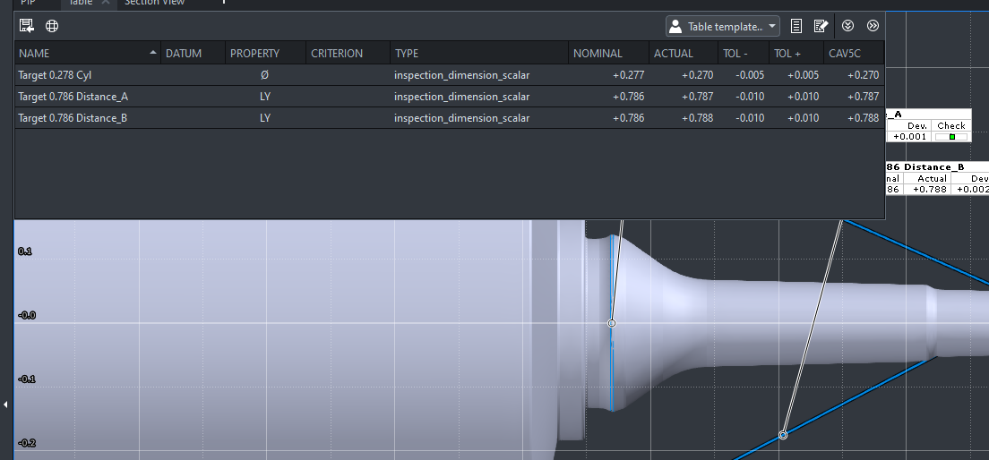

the CSV stages is somewhat predefined, but you could edit your table to show the measured values instead of the deviations:
 (the header should be changed from "DEV" to stage name for example I just realized)
Nanno

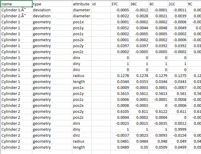

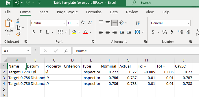

Hi Nanno, appreciate the reply, this seemed to be working well, until I exported.      File-Export-Stage data     still sends the deviation only.
As exported:    image.thumb.png.88bdb5217fcbdcae8be32889eae23c3e.png

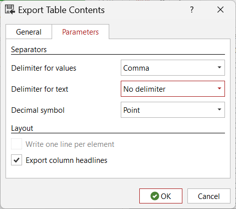

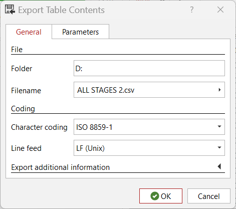

Using "table template for export" I can get it to export the measured value, but only currently viewed stage, when I need to export all in a table.
