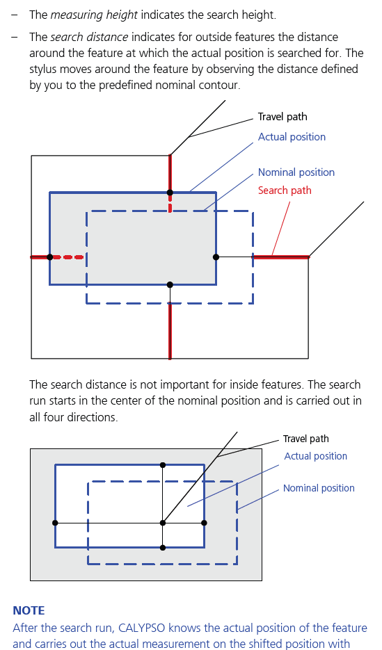

[Ja...] Posted September 4, 2025 Share Posted September 4, 2025 Hey guys, we just upgraded from Calypso 2020 to 2025. We have several structures that feature, rather loosely located, bosses. Due to their generous position tolerances, we were using "own geometry," with ample search and clearance, to find and probe them. Now, in Calypso 2025, the stylus is shooting straight for the center, as if it's attempting to do an INSIDE diameter check - yes, I made sure the feature definition was set to O.D. and not I.D. - this worked fine in 2020. Any help is appreciated. Link to comment https://qualityforum.zeiss.com/topic/24387-own-geometry-for-outside-diameters/ Share on other sites More sharing options...

[Ow...] Posted September 4, 2025 Share Posted September 4, 2025 (edited) Aside from it being a Calypso 2025 hiccup, what axis are you measuring it in, XYZ? What type of head/sensor are you using, Vast, XXT, RDS? A few maybe redundant questions. Is the cylinder at an angle? If not, you might try changing clearance distance to 0.0. Is the search distance before nominal position excessively large or too small? Do you use position points in the strategy? Could there be another unknown probe assigned in one of the strategies? Does the clearance box adequately surround the part? Has the alignment flipped or rotated? Edited September 4, 2025 Link to comment https://qualityforum.zeiss.com/topic/24387-own-geometry-for-outside-diameters/#findComment-137977 Share on other sites More sharing options...
[Ja...] Posted September 5, 2025 Author Share Posted September 5, 2025 Please sign in to view this quote. Thank you for chiming in, Owen! To answer your questions: As far as "which axis" most of the bosses live in the Z/Y plane, being approached and probed in X. Head/sensor combo is a Vast XXT with RDS. All bosses are normal to their respective axis - no angles. Search distance before nominal isn't too large, usually set to the radius of the boss itself (10mm or so.) No position or "move points" are being used. No undefined or unintentional stylus systems are being used. The clearance cube encompasses the entire structure. While I have seen Calypso invert the strategy for features, this doesn't seem to be the case here. To clarify, we use Own Geometry on some I.D. features as well - these are performing as expected. As a matter of fact, all of our 2020 measurement plans are running fine in 2025, except for this one issue. Link to comment https://qualityforum.zeiss.com/topic/24387-own-geometry-for-outside-diameters/#findComment-138001 Share on other sites More sharing options...

[Ja...] Posted September 10, 2025 Author Share Posted September 10, 2025 Please sign in to view this quote. Clearance distance is 10 (never been a problem before), but vectors are correct. It's my observation from Calypso 2020, that the clearance distance motions don't seem to apply to navigation until AFTER the "own geometry" routine has ran. I think I should clarify that I am having this issue in old, previously functional programs, written in Calypso 2020 - these are not newly-written / 2025 programs. These measurement plans have simply been loaded into 2025 and executed. They function flawlessly, outside of this strange lack of outside diameter own geometry. Again, they're unchanged from 2020 and worked fine there. Link to comment https://qualityforum.zeiss.com/topic/24387-own-geometry-for-outside-diameters/#findComment-138145 Share on other sites More sharing options...
