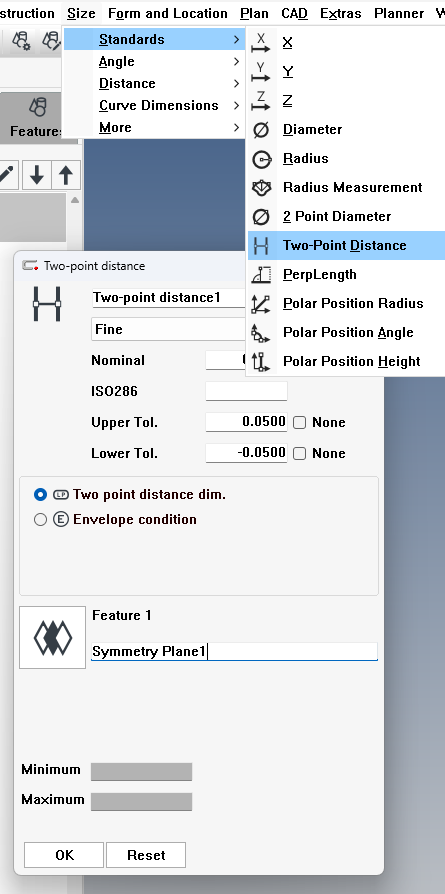

[na...] Posted September 9, 2025 Share Posted September 9, 2025 (edited) Please sign in to view this quote. If you have features of size, you can use Two-point distance characteristic. With this of course expect rolling eyeballs from people not knowing what to do with 2 results. Edited September 9, 2025 2 Link to comment https://qualityforum.zeiss.com/topic/24413-best-way-to-measure-distance-between-planes/#findComment-138085 Share on other sites More sharing options...
