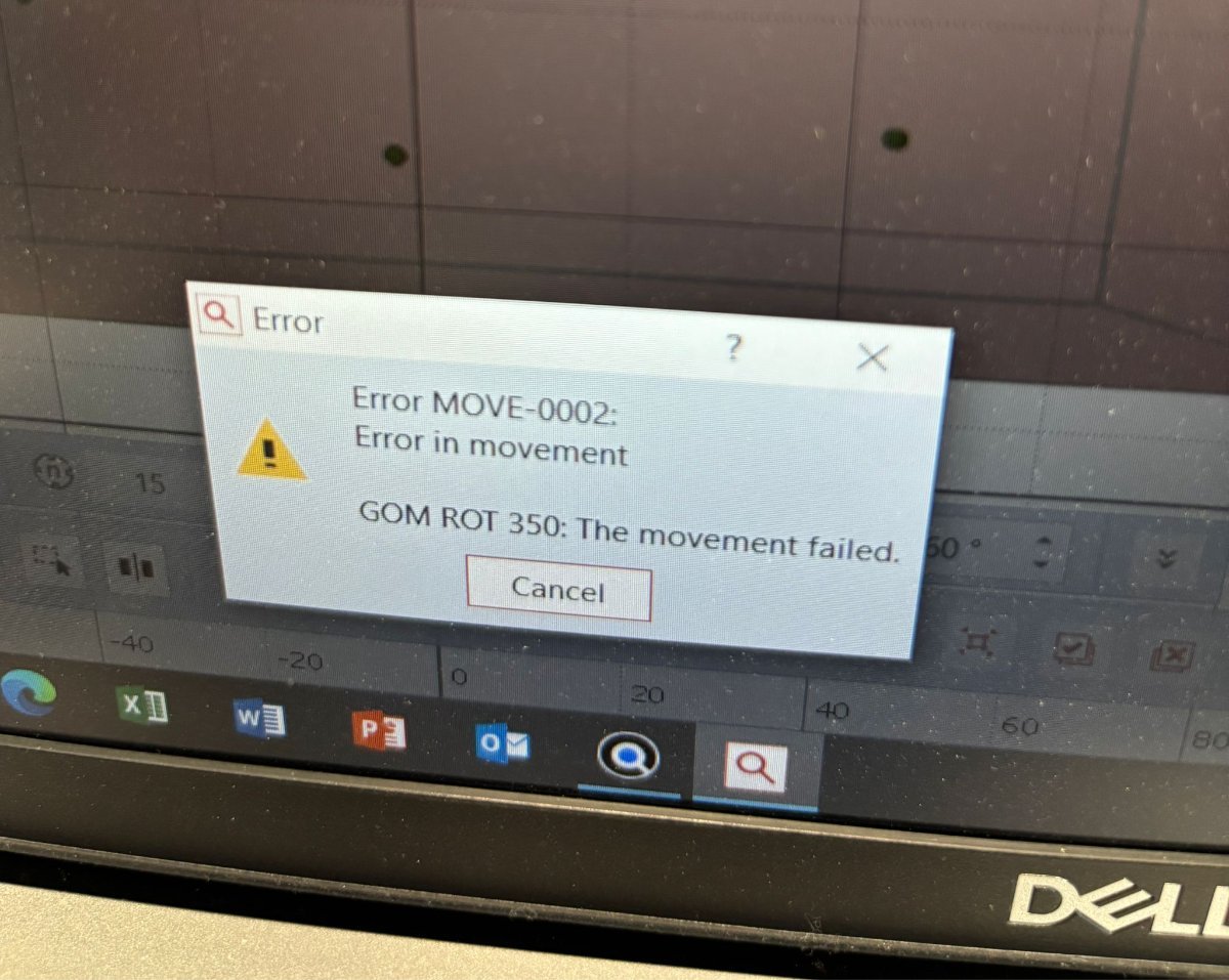

[fr...] Posted September 15, 2025 Share Posted September 15, 2025 Hi, I am encountering the following error on GOM ROT 350 in GOM INSPECT: Error MOVE-002: Error in movment GOM ROT 350: The movement failed Can you give me some information about the problem and possible solutions? Thank you! Link to comment https://qualityforum.zeiss.com/topic/24477-gom-rot-350-error-move-002/ Share on other sites More sharing options...
[Na...] Posted September 15, 2025 Share Posted September 15, 2025 Hello fra, could be a defect USB cable/connection. If changing this does not help, please contact your local support with a gomsic (help -> system analysis -> support data). Nanno Link to comment https://qualityforum.zeiss.com/topic/24477-gom-rot-350-error-move-002/#findComment-138419 Share on other sites More sharing options...
[DW...] Posted September 15, 2025 Share Posted September 15, 2025 Please sign in to view this quote. Please sign in to view this username. I do not have a system like yours but this message most likely appears because one of the table axes has an error. If you know how to log into your machine and clear the axis error and home the system, I would give it a try. Link to comment https://qualityforum.zeiss.com/topic/24477-gom-rot-350-error-move-002/#findComment-138429 Share on other sites More sharing options...
