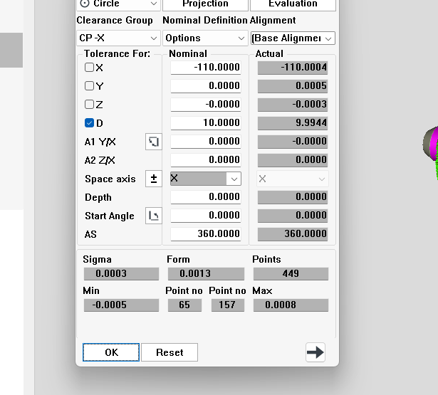

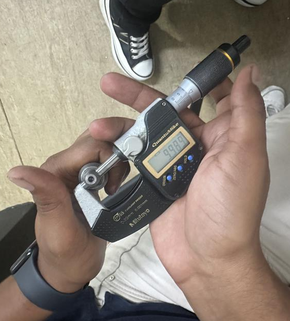

[Ma...] Posted September 16, 2025 Share Posted September 16, 2025 Good morning everybody, I am having a big dillemma in measuring this diameter of 10, As I have differences of 5 microns on all the diameters, measuring between micrometer and Zeiss. I have used various micrometer to verify and they all give me 5 microns less than the Zeiss. I have also recalibrated CMM, use temperature sensors, everything but, the difference still remains. I used gauge of 11 to measure with the same program, and they give me equal, with the same evaluation method. Can anyone help me on this? Link to comment https://qualityforum.zeiss.com/topic/24481-difference-in-measurement-of-a-diameter-of-a-shaft-between-micrometer-and-cmm/ Share on other sites More sharing options...

[Ri...] Posted September 16, 2025 Share Posted September 16, 2025 The answer is probably somewhere in the form of the feature or something with filters. Having said that, if you are chasing microns, I wouldn't recommend holding either the part or the micrometer in your hand - the heat transfer from your body to your part/mic will cause you issues. 2 Link to comment https://qualityforum.zeiss.com/topic/24481-difference-in-measurement-of-a-diameter-of-a-shaft-between-micrometer-and-cmm/#findComment-138457 Share on other sites More sharing options...

[Ow...] Posted September 16, 2025 Share Posted September 16, 2025 (edited) I've seen this discrepancy a thousand times over the years. I'm betting it is a pressure or hand generated heat transfer like Richard Shomaker mentioned. Are you using the friction thimble or the bigger body to set your zero on the micrometer standard? When using an annually calibrated or newly certified micrometer standard, that's kept in a climate controlled room, you should always use the friction thimble when setting zero on the micrometer. This ensures that you are applying the same exact force between the standard and the test piece. Also as mentioned, if the part is out of round, it will measure differently and you should be able to see that with the micrometer when rotating and checking the part. When measuring micron's, it's also good to use the same shape standard (a certified xxx cylinder) instead of the flats on a regular micrometer standard because that will ensure you are measuring the same amount of surface and force as the cylinder you are checking. Edited September 16, 2025 2 Link to comment https://qualityforum.zeiss.com/topic/24481-difference-in-measurement-of-a-diameter-of-a-shaft-between-micrometer-and-cmm/#findComment-138475 Share on other sites More sharing options...
[Ma...] Posted September 17, 2025 Author Share Posted September 17, 2025 The roundness, I have is 0.001. Yes, I used micrometer to measure a gauge of 11mm and it was perfect, 11.000 and also in the CMM, the 11mm gave me 11.000. Then, I checked the cylindricity and it was also 2 microns. Please sign in to view this quote. Link to comment https://qualityforum.zeiss.com/topic/24481-difference-in-measurement-of-a-diameter-of-a-shaft-between-micrometer-and-cmm/#findComment-138519 Share on other sites More sharing options...

[Ma...] Posted September 17, 2025 Share Posted September 17, 2025 This is a common issue when you try and measure a diameter against a two-point gage. What is the evaluation method set to? LSQ or Minimum circumscribed? Are you comparing the measured point that are directly across from each other? Just remember you are using a $200.00 tool with a fixed measuring method, 2-point distance, to check a CMM with different algorithm settings. 1 Link to comment https://qualityforum.zeiss.com/topic/24481-difference-in-measurement-of-a-diameter-of-a-shaft-between-micrometer-and-cmm/#findComment-138545 Share on other sites More sharing options...
[Wo...] Posted September 17, 2025 Share Posted September 17, 2025 How are you holding the part? If you have it vertically in a chuck - the higher you measure the more likely it is that the part is moving imperceptibly. I run into this all the time. Also, I don't really trust QuantuMike - the spindle moves too fast and it's easy to apply to much pressure. Regular digimatic or High precision mics work much better. Link to comment https://qualityforum.zeiss.com/topic/24481-difference-in-measurement-of-a-diameter-of-a-shaft-between-micrometer-and-cmm/#findComment-138575 Share on other sites More sharing options...

[Da...] Posted September 17, 2025 Share Posted September 17, 2025 A scanning sensor is all about compromise. The software has to find the best calibration for different speeds, different probing forces, different deflections of the probe. After calibration it all comes down to one calibration setting combined with a deflection dependent correction factor. You will see the problem this way: take a known gauge plug and a gauge ring, both calibrated by a good lab (ideally the SAME lab), calibrate a probe and scan them both. You WILL see a difference in the precision of the scan. If you need better values, you need to optimize your calibration values and saving them as separate probes, maybe a diameter 5 probe for inner diameters and one for outer diameters, and if in special cases you do the optimization for different diameter ranges and different speeds. For most other purposed you can continue using the standard calibration. This will yield much better results that are directly comparable to simpler methods like micrometers. Link to comment https://qualityforum.zeiss.com/topic/24481-difference-in-measurement-of-a-diameter-of-a-shaft-between-micrometer-and-cmm/#findComment-138579 Share on other sites More sharing options...

[Te...] Posted September 22, 2025 Share Posted September 22, 2025 make sure the diameter characteristic is using Minimum Circumscribed Element Link to comment https://qualityforum.zeiss.com/topic/24481-difference-in-measurement-of-a-diameter-of-a-shaft-between-micrometer-and-cmm/#findComment-138735 Share on other sites More sharing options...
