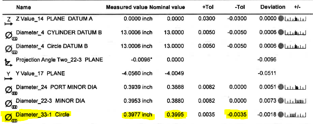

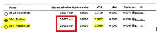

[Ni...] Posted September 17 Share Posted September 17 Position (M) is the value to read for holes with max material modifiers. I cannot explain how the report calculates everything. All I understand is below: For hole 33-1 the Max Material hole size is ø.3960” and the measured hole size is ø.3977” so the bonus tolerance is .0017. Which on feature 35-1 is shown by the difference between the Position and Position (M) with .0067 - .0050 = .0017” I am confused as to why the measured values are different. I understand where the difference in the allowable tolerance came from. Can someone provide clarification. Link to comment Share on other sites More sharing options...

[Ch...] Posted November 13 Share Posted November 13 I'm new to Calypso software, this one has me very confused as well. I ended up turning off M unless I needed it. 😟 Link to comment Share on other sites More sharing options...
[Ma...] Posted November 13 Share Posted November 13 Please sign in to view this username. If drawing is not demanding (M) / (L) in tolerance band, then don't use it. If you are speaking about protocol, then you should know, that this information is only used for SPC 1 Link to comment Share on other sites More sharing options...
