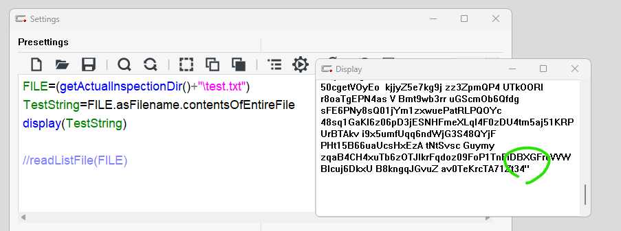

[No...] Posted September 18, 2025 Share Posted September 18, 2025 (edited) What is the correct way to read an entire (big) text file into a string in PCM? I tried something like this: File="C:\test.txt" TestString=File.asFilename.contentsOfEntireFile display(TestString) The first two lines work, but if the text file exceeds a certain size, the display() function fails, always complaining about a "missing second quotation mark", followed by various other errors. The same happens with other string operations, e.g. len(TestString). Is this a PCM bug or what am I doing wrong? I know there is readListFile(), but in the end I need a string. And as soon as I convert the list to a string, the same errors occur. Edited September 18, 2025 Link to comment https://qualityforum.zeiss.com/topic/24505-read-big-text-file-into-a-string/ Share on other sites More sharing options...

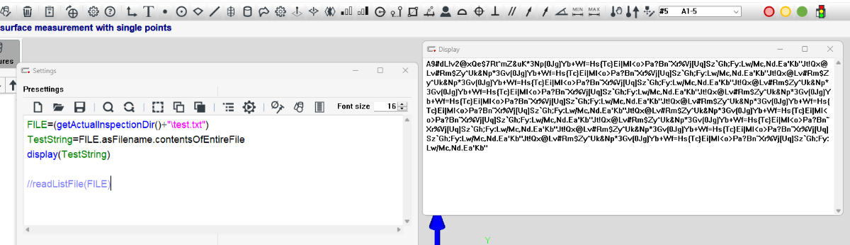

[Ch...] Posted September 18, 2025 Share Posted September 18, 2025 (edited) Please sign in to view this username. seems to work for me : well this was only 2000 characters, how big is your file ?? EDIT : Also worked with 20,000 characters too. Calypso 2023 7.6 with random generated text from ChatGPT 😁 Edited September 18, 2025 Link to comment https://qualityforum.zeiss.com/topic/24505-read-big-text-file-into-a-string/#findComment-138605 Share on other sites More sharing options...

[Ch...] Posted September 18, 2025 Share Posted September 18, 2025 I made the first and last characters quotation marks " " and added a few more quotes throughout, still functioned here. Link to comment https://qualityforum.zeiss.com/topic/24505-read-big-text-file-into-a-string/#findComment-138611 Share on other sites More sharing options...
