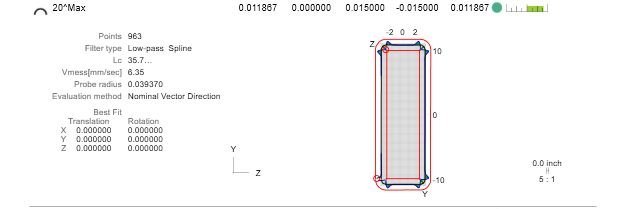

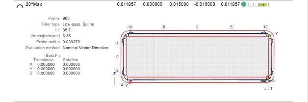

[Ja...] Posted September 22, 2025 Share Posted September 22, 2025 How do I get PiWeb to rotate a plot automatically? The plot in this report always shows up vertically oriented. I have to go in and change the orientation manually every time I run the program. I want it to show up horizontally oriented each time. Link to comment https://qualityforum.zeiss.com/topic/24529-piweb-plot/ Share on other sites More sharing options...
[Ma...] Posted September 23, 2025 Share Posted September 23, 2025 Unfortunately there is no guaranteed way to force a specific view. You would need to edit that template to have specific view. You can try to make a rotated alignment in which it will report this, but i highly doubt it will work. Link to comment https://qualityforum.zeiss.com/topic/24529-piweb-plot/#findComment-138739 Share on other sites More sharing options...
[Ja...] Posted September 23, 2025 Author Share Posted September 23, 2025 That's a bummer. If I change the template, it would affect all of the characteristics in each report for each program run. I don't want to do that. Thanks for the reply. Link to comment https://qualityforum.zeiss.com/topic/24529-piweb-plot/#findComment-138755 Share on other sites More sharing options...
[Sv...] Posted September 23, 2025 Share Posted September 23, 2025 130 / 5.000 You can make a copy of the template and then change it for a test plan and select it and run the other plans nora Link to comment https://qualityforum.zeiss.com/topic/24529-piweb-plot/#findComment-138759 Share on other sites More sharing options...
[Ja...] Posted September 23, 2025 Author Share Posted September 23, 2025 Sounds good. How do I change the template and how do I assign it to a specific plan? Link to comment https://qualityforum.zeiss.com/topic/24529-piweb-plot/#findComment-138771 Share on other sites More sharing options...
[Ma...] Posted September 23, 2025 Share Posted September 23, 2025 Open "Multiple printout settings" and click on "pencil" icon - this will show PiWeb template editor - then you can save it in measuring program folder - i believe as "PiWeb template" or something similar ( can be found online ), then you can select this edited template in another tab of templates. Link to comment https://qualityforum.zeiss.com/topic/24529-piweb-plot/#findComment-138803 Share on other sites More sharing options...
[Sv...] Posted September 24, 2025 Share Posted September 24, 2025 Test Plan > Multiple Protocol > Protocol Elements. Multiple protocols can be used for one plan there. At the bottom are the settings; on the right, there's a pencil symbol and three dots. You can edit the settings using the pencil. Piweb Designer opens, and you can select a template using the three dots. Then simply save as and give it a new name. Link to comment https://qualityforum.zeiss.com/topic/24529-piweb-plot/#findComment-138855 Share on other sites More sharing options...
