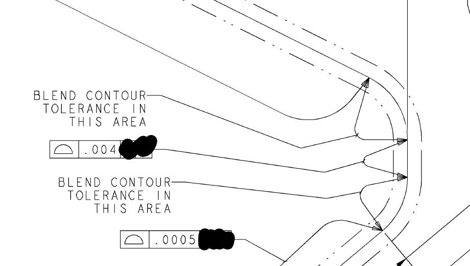

[Ra...] Posted September 23, 2025 Share Posted September 23, 2025 If I have certain segments of a curve toleranced differently, is there a way to "blend" the tolerance before the start of one segment, and the end of another? Link to comment https://qualityforum.zeiss.com/topic/24545-profile-blend-tolerance-curve/ Share on other sites More sharing options...
[Ri...] Posted September 23, 2025 Share Posted September 23, 2025 Please sign in to view this username. Go to C:\Program Files\Zeiss\CALYPSO 8.0\userinfo\manuals\en-US, and open the Calypso_01_curve.pdf. On page 74 it talks about how to define tolerances to a curve. 2 Link to comment https://qualityforum.zeiss.com/topic/24545-profile-blend-tolerance-curve/#findComment-138817 Share on other sites More sharing options...
[Ra...] Posted September 24, 2025 Author Share Posted September 24, 2025 Sorry, I don't think I was clear. I have the segments toleranced individually. But the drawing calls this out So I want the tolerance band to gradually shrink until I hit the .0005 profile callout. I only have Calypso 19, and the kurve pdf didn't seem to mention this functionality. Link to comment https://qualityforum.zeiss.com/topic/24545-profile-blend-tolerance-curve/#findComment-138885 Share on other sites More sharing options...
[Ri...] Posted September 24, 2025 Share Posted September 24, 2025 Please sign in to view this username. Start on page 77. "Having tolerances for curve points calculated" 2 Link to comment https://qualityforum.zeiss.com/topic/24545-profile-blend-tolerance-curve/#findComment-138899 Share on other sites More sharing options...
