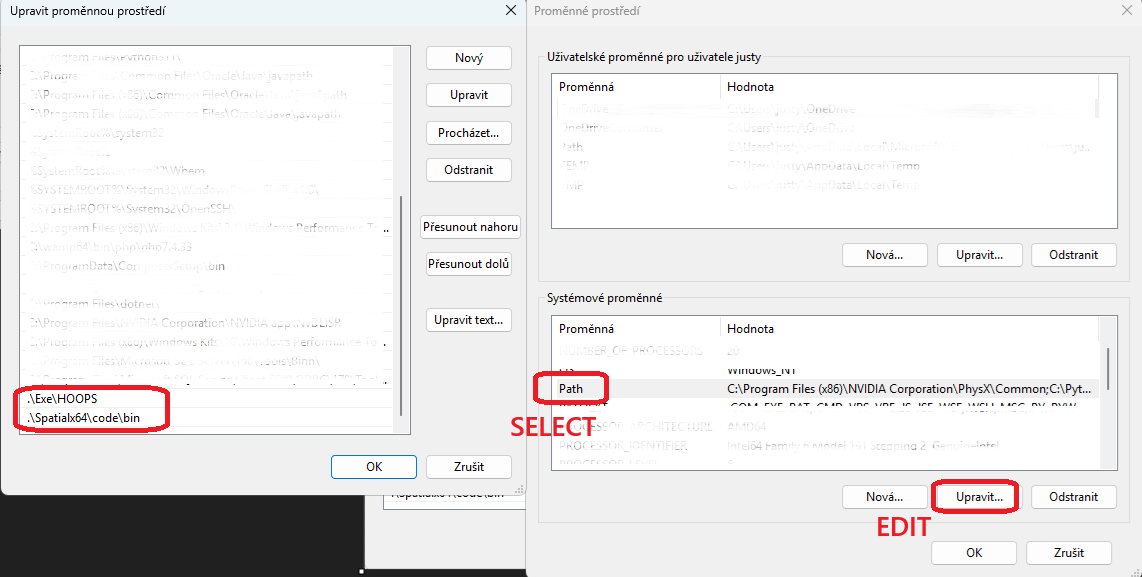

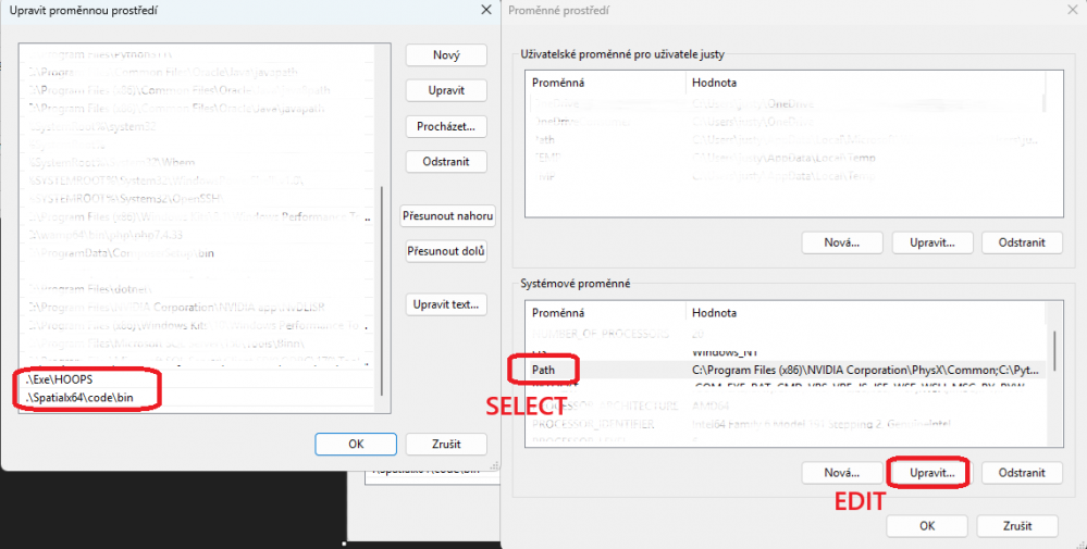

[Ch...] Posted September 30, 2025 Share Posted September 30, 2025 You may receive an error message if you also have Calypso installed on your computer. You'll need to adjust the environment variables. You need to place (.\Spatialx64\code\bin;.\HOOPS;) at the beginning. Link to comment Share on other sites More sharing options...
[Ri...] Posted September 30, 2025 Share Posted September 30, 2025 Please sign in to view this quote. Can you elaborate more? Link to comment Share on other sites More sharing options...
[Ch...] Posted September 30, 2025 Share Posted September 30, 2025 No, my English is not good enough to explain it Link to comment Share on other sites More sharing options...
[Ma...] Posted September 30, 2025 Share Posted September 30, 2025 (edited) Please sign in to view this quote. Edit enviroment variables -> System variables -> Path Edited September 30, 2025 2 Link to comment Share on other sites More sharing options...
[Ri...] Posted October 1, 2025 Share Posted October 1, 2025 Ah. I didn't open the Path variable and notice it at the end. Then I ran into the fun part of the variable string being too long. Hahaha. Link to comment Share on other sites More sharing options...

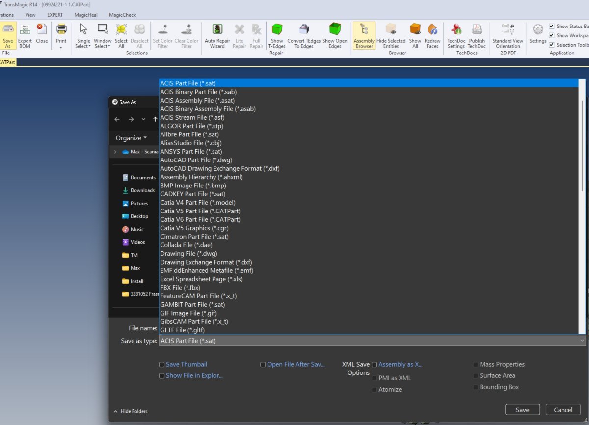

[M1...] Posted October 2, 2025 Share Posted October 2, 2025 As we are handling different type of CAD-formats and Calypso only support Acis (without paying a tons of money), we are in the process of evaluating the TransMagic software to be able to be more efficient. CAD-formats 1 Link to comment Share on other sites More sharing options...
