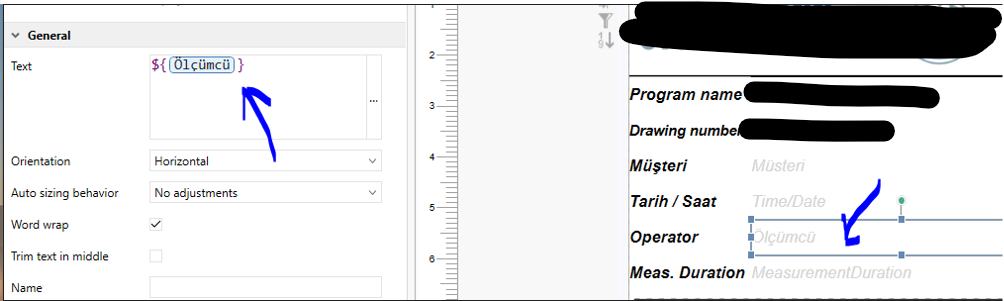

[Ro...] Posted September 24, 2025 Share Posted September 24, 2025 I know this is technically not the correct place to ask this, but I asked on the PiWeb page and received 1 answer that did not work. My company is asking me to add a signature line to the reports so we know who ran that particular program. I have gone to the Measurement tab, Multiple Report, Select report header parameters, and clicked the Run radio button by Signature. I have gone into the PiWeb Designer, added a Text Box and named it Signature. I then added a Text Field Input box. In the Select report header parameters box, I hovered over the signature on the right side and had the pop up come up. I entered that into the Text input field, Input. What I entered is: ${Qdb.Property[ProtocolHeaderSignature}]. When I run the program, I see the Signature text come up, but I cannot get the signature to appear. It comes up to enter the signature when starting the program, but will not print out. What am I doing wrong. I have very limited knowledge of PiWeb and am trying to learn as I go. Link to comment https://qualityforum.zeiss.com/topic/24553-help-please/ Share on other sites More sharing options...

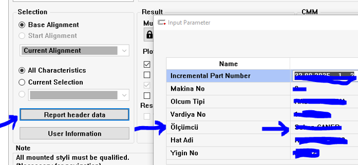

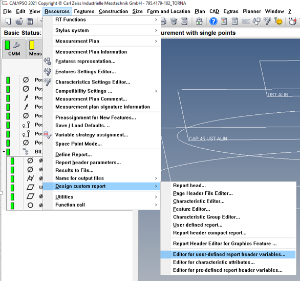

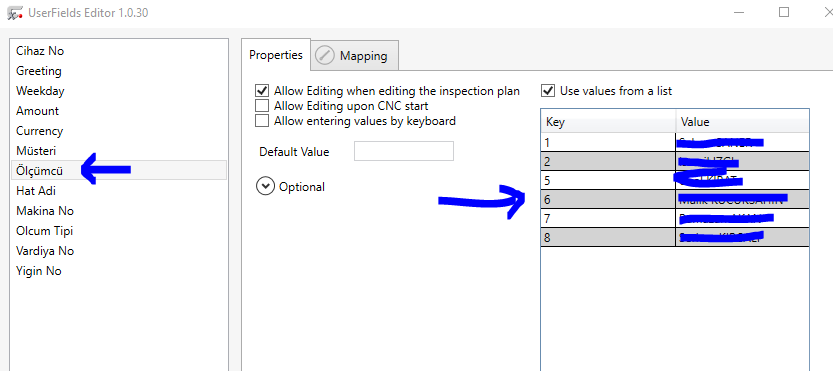

[Ün...] Posted September 24, 2025 Share Posted September 24, 2025 (edited) İmza yerine ölçümü yapan operatörün adını ekleyebilirsiniz. kaynaklar + Kullanıcı tanımlı rapor başlık değişkenleri için özel rapor + düzenleyici tasarımı Buraya "operatör" ekleyin ("ölçümcü" olarak görünür). Yan taraftaki CMM cihazında ölçüm yapacak operatörlerin isimlerini girin. Piweb raporunuzu açın ve başlık ayarlarınızı düzenleyin Rapor başlık verileri bölümündeki giriş parametrelerinden ölçümü gerçekleştirecek kullanıcı adını seçerek ölçüm yapabilirsiniz. Bu sayede ölçümü gerçekleştiren kullanıcıyı rapor başlığında görebilirsiniz. Edited September 24, 2025 1 Link to comment https://qualityforum.zeiss.com/topic/24553-help-please/#findComment-138883 Share on other sites More sharing options...
[Ro...] Posted September 24, 2025 Author Share Posted September 24, 2025 Please sign in to view this quote. Thanks Tom. I just did that and it worked flawlessly. Much appreciated. Link to comment https://qualityforum.zeiss.com/topic/24553-help-please/#findComment-138893 Share on other sites More sharing options...
[Ro...] Posted September 25, 2025 Author Share Posted September 25, 2025 So I am able to do this process on my offline seat and our Duramax. I try to open the Editor for user-defined report header variables on our Contura G2 and it will not open. I tried shutting down the program and re-opening it and nothing. I cannot figure out for the life of me why I cannot get this to open. Any ideas? Link to comment https://qualityforum.zeiss.com/topic/24553-help-please/#findComment-138935 Share on other sites More sharing options...
[Ma...] Posted September 25, 2025 Share Posted September 25, 2025 Path for that app is like this: c:\Program Files (x86)\Zeiss\CALYPSO 6.6\bin\UserFieldsEditor\UserFields.exe I hope IT does not block this at your machine. You can edit that file manually, but it's not much user friendly :-) Path for manually edit: c:\Users\Public\Documents\Zeiss\CALYPSO 6.6\protocol\protform\userfields.ini Link to comment https://qualityforum.zeiss.com/topic/24553-help-please/#findComment-138943 Share on other sites More sharing options...
