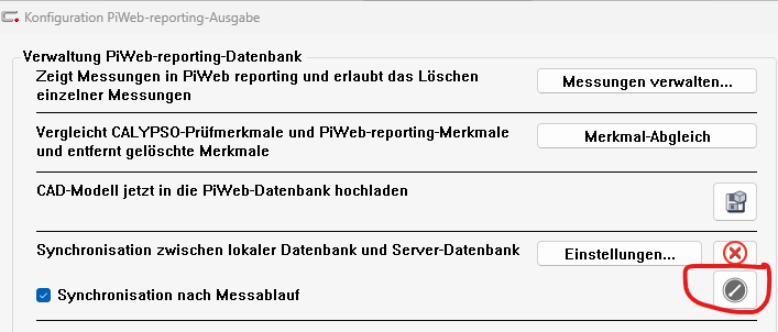

[Ni...] Posted September 25, 2025 Share Posted September 25, 2025 Hello Together, i am occuring often times the problem with our PiWeb that the model datas in the properties are missing or was replaced with at totally different model. In the same time our company has the problem that we have many old programs over 10K and there is everywhere the same wrong model inside. Does it give some possibilitys to automatically load up the cad data of the programs if i am measuring the parts over the Autorun, because if i measure it as a simulation in calypso and connect to the Piweb Server right before the simulation then it works. Has somebody occured this problem ? Kind regards and previously thank you for the help Link to comment https://qualityforum.zeiss.com/topic/24563-piweb-models-dont-update/ Share on other sites More sharing options...

[Ni...] Posted December 1, 2025 Author Share Posted December 1, 2025 Hello Mr Suetcue, i talked with someon on the support, the only way would be to delete all meshmodels and let it load up the new model on calypso itself. it dont update itselfs. Kind Regards 1 Link to comment https://qualityforum.zeiss.com/topic/24563-piweb-models-dont-update/#findComment-142811 Share on other sites More sharing options...
