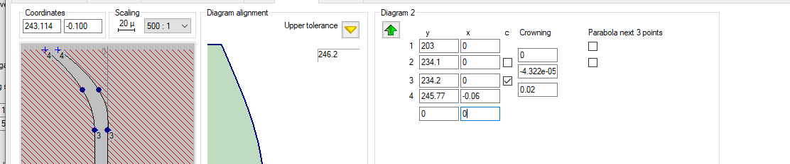

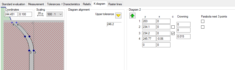

[Is...] Posted September 25, 2025 Share Posted September 25, 2025 I am setting up a K chart with circular tip relief, I am only given the start of tip relief and the end limit points of the tolerance band. The print does not call out a tip relief amount or crowning amount. I am eyeballing approx. .019mm of tip relief needed while gear pro consistently overrides it to .015. I am curious as to how gear pro calculates that. Screenshot is attached of both scenarios. Link to comment https://qualityforum.zeiss.com/topic/24569-k-chart-tip-crowning/ Share on other sites More sharing options...
[Ro...] Posted September 26, 2025 Share Posted September 26, 2025 deactivate the checkbox "c", then you can define the crowning value as you expect. The "c" means continous connection between the two points. For this reason you always need a second crowning on the other end to calculate "continues". 1 Link to comment https://qualityforum.zeiss.com/topic/24569-k-chart-tip-crowning/#findComment-138989 Share on other sites More sharing options...
