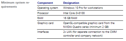

[Fl...] Posted September 25, 2025 Share Posted September 25, 2025 Hello everyone, What is the minimal requirement for an offline planner seat, in 7.4 version ? I don't see any information... Thanks, Link to comment https://qualityforum.zeiss.com/topic/24571-system-requirement-for-planner/ Share on other sites More sharing options...
[Lu...] Posted September 25, 2025 Share Posted September 25, 2025 (edited) Hello, There is not a planner specific requirement. This is the minimum system requirement listed in the 7.4 release notes: Edited September 25, 2025 Link to comment https://qualityforum.zeiss.com/topic/24571-system-requirement-for-planner/#findComment-138959 Share on other sites More sharing options...

[Br...] Posted September 29, 2025 Share Posted September 29, 2025 Most important requirement that people/IT fails to recognize is the need for the NVIDIA OpenGL graphics card. This is a must, especially for planner. The graphics card must be set correctly. the Base profile is the standard setting, but the 3d setting should be set to "autodesk motion builder compatible" . For information on how to set this, please follow the Knowledge Base link below: https://portal.zeiss.com/knowledge-base?id=528774 1 Link to comment https://qualityforum.zeiss.com/topic/24571-system-requirement-for-planner/#findComment-139099 Share on other sites More sharing options...

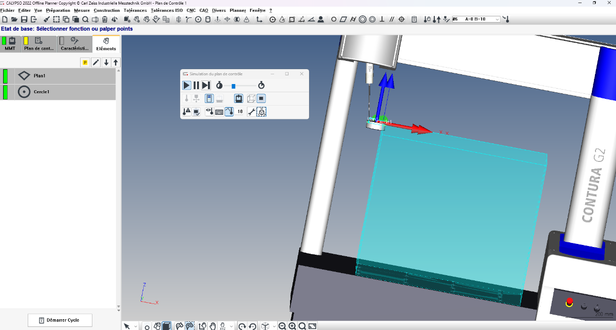

[Fl...] Posted October 23, 2025 Author Share Posted October 23, 2025 Hi everyone ! I start to work on the planner. I don't understand how positionning to the start on the machine. Can someone help me ? Link to comment https://qualityforum.zeiss.com/topic/24571-system-requirement-for-planner/#findComment-140715 Share on other sites More sharing options...

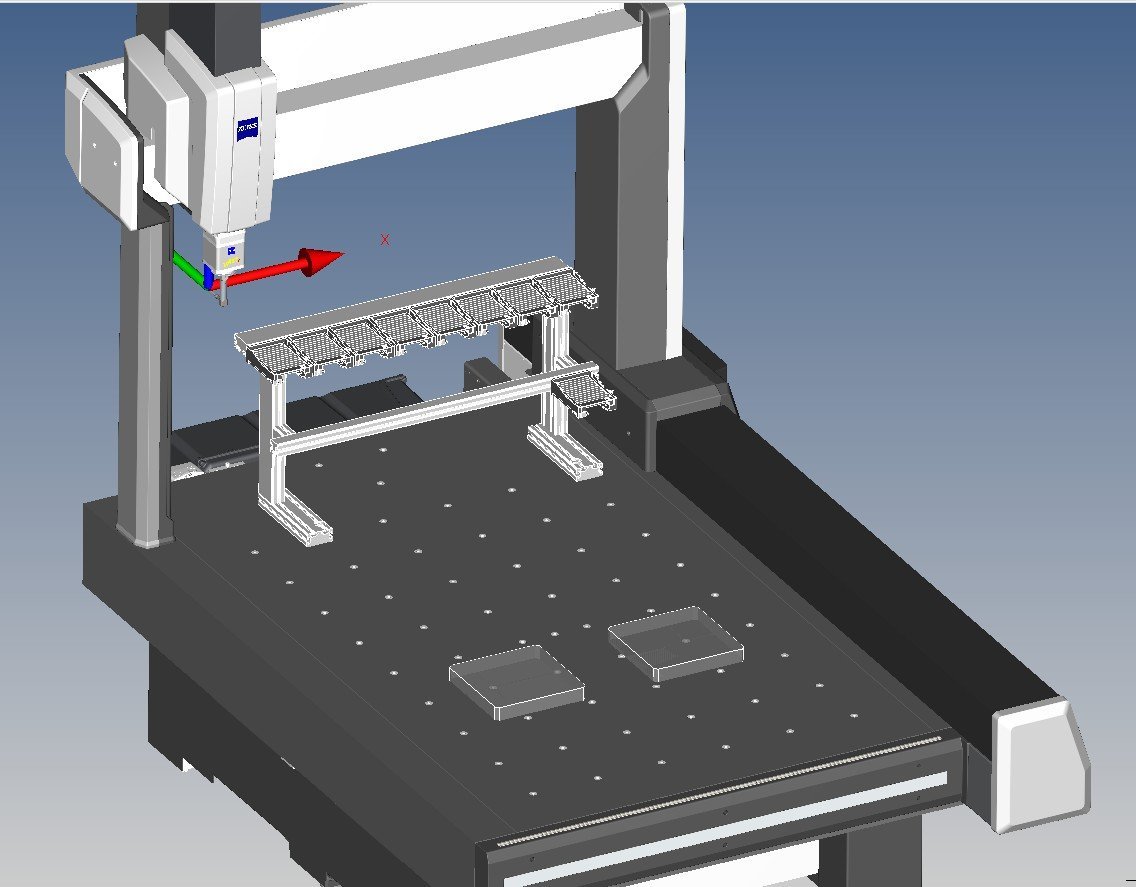

[Ka...] Posted October 24, 2025 Share Posted October 24, 2025 (edited) Hi Florent, Wellcome to the abyss "Planner" 🙂 Wich CALYPSO version do you use? Planner up to CALYPSO 8.0 has not been further developed for years. From version 8.0 onwards, the software is proactively unusable due to extremely slow processing. Positioning the component correctly on the virtual machine is very tricky. One wrong click in the sequence and you have to start all over again. The problem is that the base system has to move correctly with it. In the end, it is positioned correctly, but you don't really benefit from all the effort. -Not every CMM is stored as a virtual machine in the Planner. -You cannot add a probe rack in the virtual machine. -No collisions with interfering geometries such as probe racks or other parts located on the Marmor plate are detected. -No collision with the machine's own geometry is detected. -In most cases, no collision with the table is detected either. -A message indicating that an end stop has been reached is only generated under certain conditions. -The simulation is much slower. As I do not see any advantage in simulating the machine, I do not use this feature at all. My urgent recommendation: don't do it !!!! It is highly unlikely that the planner in Calypso 8.x will ever be better. But to be honest, I have no hope that it will be. Regards Karsten Edited October 24, 2025 Add CMM text Link to comment https://qualityforum.zeiss.com/topic/24571-system-requirement-for-planner/#findComment-140765 Share on other sites More sharing options...
[No...] Posted October 24, 2025 Share Posted October 24, 2025 (edited) Please sign in to view this quote. It's only tricky if you absolutely need to use those fancy "position-by-clicking" functions. I don't, instead I mostly use the translation / rotation input fields. "Drag base system" has to be active while moving the part, but that's the default. But one thing is true: Although Planner makes you think so, it's not really capable of simulating all the stuff on the granite plate 100% accurately. For me it's a tool to check for collisions. For that I don't need the CMM simulation at all. Please sign in to view this quote. Sad but true. Please sign in to view this quote. Ahem..... But it's true, you cannot add any type of probe rack. Especially the lack of a ProMax simulation is annoying, since it's moving and one would probably like to check it for collisions. Please sign in to view this quote. At least partly true. I can't confirm alll of it as I don't use it. Please sign in to view this quote. THAT is really hilarious - in a bad sense. That the virtual machine can travel way beyond its physical limits without any warning message is something I never understood, even though I don't use it. It makes the name "simulation" sound ridiculous. Please sign in to view this quote. That's because it's not meant to be an accurate simulation of a physical CMM's speed, but mainly checks for collisions. And that can be a demanding task with complex part models. Please sign in to view this quote. I'm not THAT dismissive towards it. It's a matter of what you expect. DO NOT expect a 100% simulation of a physical CMM's behavior. Expect a tool that enables you to check for collisions offline. It has its annoying bugs, but when you've learned to work around or ignore them, it can be a useful tool. If that alone is worth its money is another story. Edited October 24, 2025 Link to comment https://qualityforum.zeiss.com/topic/24571-system-requirement-for-planner/#findComment-140769 Share on other sites More sharing options...
[Ka...] Posted October 24, 2025 Share Posted October 24, 2025 Norbert, Thank you for seeing some points in a less negative light. I agree that the tool is useful, but you have to be aware of the pitfalls. Zeiss promises a Porsche, but the customer gets an R4. Both cars drive differently, though... 🙂 About probe racks: No racks are available for XXT probe plates. Link to comment https://qualityforum.zeiss.com/topic/24571-system-requirement-for-planner/#findComment-140783 Share on other sites More sharing options...
[Fl...] Posted October 24, 2025 Author Share Posted October 24, 2025 Hello, It's ok now ! Sorry guys but for the moment, I really like the simulation ! Of course, if we have in mind that is not 100% sure to avoid 100% of collisions. My first program passed succesfully on one time on the CMM this morning, because I work on the simulation before. 2 or 3 collisions detected by the planner. So it can help ! I'm on 7.4 Link to comment https://qualityforum.zeiss.com/topic/24571-system-requirement-for-planner/#findComment-140797 Share on other sites More sharing options...
[No...] Posted October 24, 2025 Share Posted October 24, 2025 Please sign in to view this quote. I wonder what you would say if you saw how Planner/Sim. works with an O-Inspect. That's not even an Isetta 🤣 Plus Zeiss sold us an additional 600€ graphics dongle for optical simulation back then, which isn't even necessary... Link to comment https://qualityforum.zeiss.com/topic/24571-system-requirement-for-planner/#findComment-140805 Share on other sites More sharing options...
[Ch...] Posted October 24, 2025 Share Posted October 24, 2025 Agree, I just simulate the Z RAM and probe in most cases. In rare case I'll simulate probe rack and machine to ensure clearance, but performance is too slow with them. If performance wasn't an issue - I probably would prefer to have them. It's not my cpu, I have 80+GB GPU RAM and 128GB RAM on intel Core9. Yeah I agree, allowing the CMM to travel in X or Y beyond the limits is a bit silly. I would like to actually have the option to determine if I'm going to hit an end stop. Link to comment https://qualityforum.zeiss.com/topic/24571-system-requirement-for-planner/#findComment-140807 Share on other sites More sharing options...
[No...] Posted October 27, 2025 Share Posted October 27, 2025 Please sign in to view this quote. Maybe performance would improve if they would use something like CUDA for the collision checks. My observation is that as the complexity of geometry surrounding the stylus increases, preformance drops more and more. GPUs are optimized for tasks like this, so why not use this capability? 1 Link to comment https://qualityforum.zeiss.com/topic/24571-system-requirement-for-planner/#findComment-140859 Share on other sites More sharing options...
