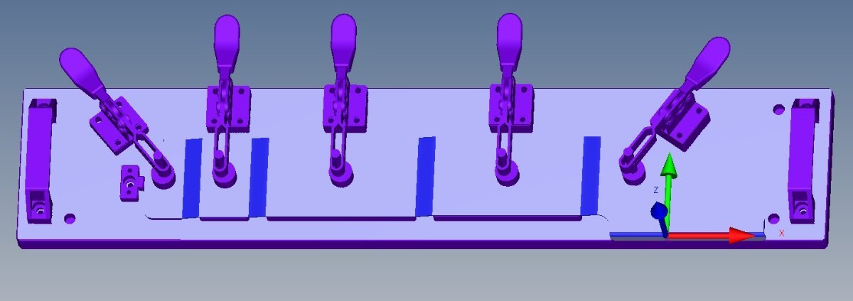

[Ke...] Posted September 25, 2025 Share Posted September 25, 2025 I have a CAD model with 5 DE-STA-CO Clamps as part of the model along the back side of the fixture. Is it possible in Calypso to remove 1 of the clamps? TIA Link to comment https://qualityforum.zeiss.com/topic/24575-remove-part-of-a-cad-model/ Share on other sites More sharing options...
[Ma...] Posted September 25, 2025 Share Posted September 25, 2025 If you have an assembly model, then it's easier. You can go to menu CAD -> Modify CAD entities, there you can select faces and hide them or remove them. Link to comment https://qualityforum.zeiss.com/topic/24575-remove-part-of-a-cad-model/#findComment-138957 Share on other sites More sharing options...
[To...] Posted September 25, 2025 Share Posted September 25, 2025 Assuming each of the entities are separate model, n the Modify CAD entities window mentioned by Martin, you can click the Edit Body tab and then you can select the each separate item. Delete or Hide Link to comment https://qualityforum.zeiss.com/topic/24575-remove-part-of-a-cad-model/#findComment-138961 Share on other sites More sharing options...
[No...] Posted September 26, 2025 Share Posted September 26, 2025 Addition: Do not heal the model before trying this. Healing turns your model into one single body. 1 Link to comment https://qualityforum.zeiss.com/topic/24575-remove-part-of-a-cad-model/#findComment-138985 Share on other sites More sharing options...

[To...] Posted September 26, 2025 Share Posted September 26, 2025 (edited) Please sign in to view this username. Also, in the Modify CAD window, there is a "Hierarchy" tab. There, you can tick/un-tick display of individual elements or bodies. Right-clicking on the item also offers you the choice of hiding or deleting items. Edited September 26, 2025 1 Link to comment https://qualityforum.zeiss.com/topic/24575-remove-part-of-a-cad-model/#findComment-139011 Share on other sites More sharing options...
