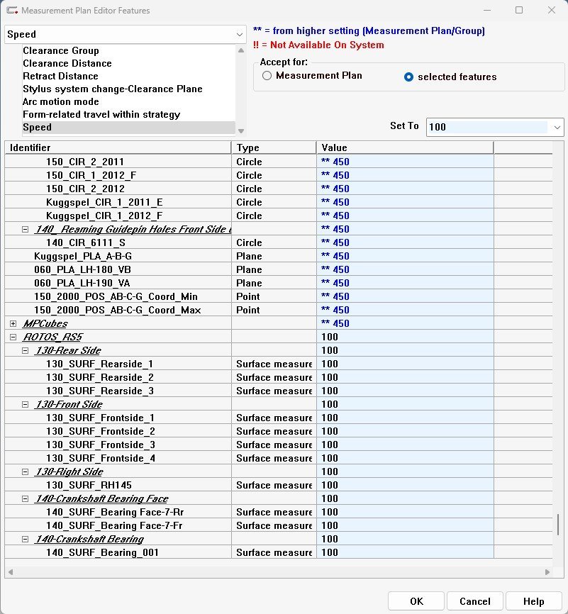

[Ed...] Posted September 26, 2025 Share Posted September 26, 2025 We have Accura II CMMs that run Measurement Plan with a measurement travel speed of 450 mm/s in programs with VAST and other Measuriment Plan with measurements using the ROTOS sensor. In these programs, we use a reduced speed of 100 mm/s. We need to unify the two programs in the same Measurement Plan, but we would not like the measurements with the ROTOS sensor to run at a speed of 450 mm/s. We would like the CMM's travel speed to be reduced from 450 mm/s to 100 mm/s when measurements with ROTOS begin.How can I make this work? I changed the speed in Measurement Plan Editor Features=>Travel+>Speed, but the unified Measurement Plan did not respect the configured speeds. A collision using the ROTOS sensor with the CMM at a speed of 450 mm/s would be catastrophic. Can ou help us? Link to comment https://qualityforum.zeiss.com/topic/24577-how-to-perform-tactile-and-rotos-measurements-with-different-travel-speeds-on-the-same-measurement-plane/ Share on other sites More sharing options...

[Ch...] Posted September 26, 2025 Share Posted September 26, 2025 using PCM and SetInspectionDrivingSpeed() might be an option. 1 Link to comment https://qualityforum.zeiss.com/topic/24577-how-to-perform-tactile-and-rotos-measurements-with-different-travel-speeds-on-the-same-measurement-plane/#findComment-139035 Share on other sites More sharing options...
[Ed...] Posted September 30, 2025 Author Share Posted September 30, 2025 Please sign in to view this username. and Please sign in to view this username. I set the speed using the Measurement Plan Editor Features and used the PCM SetInspectionDrivingSpeed() command, but neither worked as I expected. 😞 Link to comment https://qualityforum.zeiss.com/topic/24577-how-to-perform-tactile-and-rotos-measurements-with-different-travel-speeds-on-the-same-measurement-plane/#findComment-139247 Share on other sites More sharing options...
[Ed...] Posted October 2, 2025 Author Share Posted October 2, 2025 Hello friends Please sign in to view this username. and Please sign in to view this username. , I ran the test again with the PCM SetInspectionDrivingSpeed()command and it worked. Thank you very much for your help. 😁 Link to comment https://qualityforum.zeiss.com/topic/24577-how-to-perform-tactile-and-rotos-measurements-with-different-travel-speeds-on-the-same-measurement-plane/#findComment-139389 Share on other sites More sharing options...
