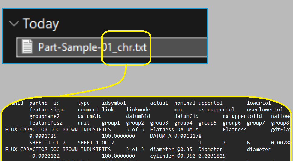

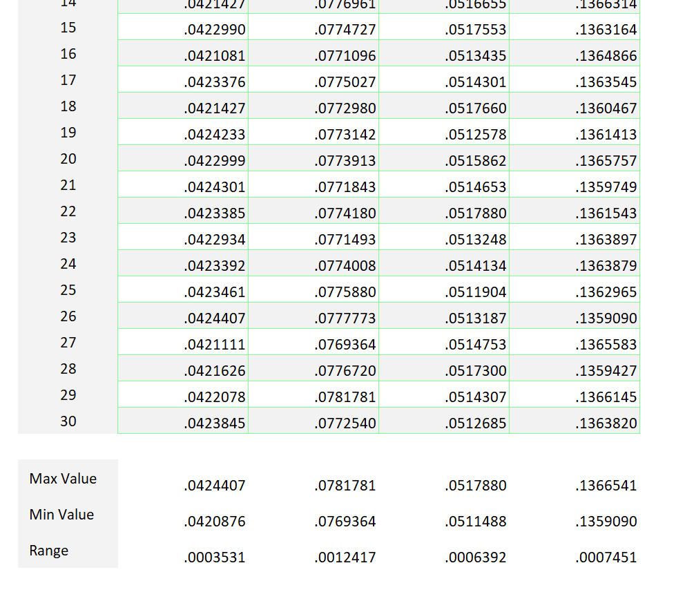

Popular Post [Je...] Posted September 30, 2025 Popular Post Share Posted September 30, 2025 Hi Please sign in to view this username. . I've been meaning to post about the following, and your question presents a good place to do so: TLDR: You don't have to use Zeiss's "native" but left-for-dead excel output option. Using large-language models or an air-breathing human coder, you can automate a better solution. I did, and it took me a couple of hours. =============================== 🎻🎵 cue sad, backstory violin music 🎵 I grew tired of waiting for Zeiss to acknowledge years of customer-voiced need for effective results output to Excel. Rather than recognize PiWeb as a failure-to-launch, or at least reposition it as a standalone, optional SPC software, Zeiss seems to have embraced the sunk-cost fallacy to the tune of "la la la. we're not listening..." While you can find a host of SPC systems represented in manufacturing, 99% of businesses worldwide utilize Microsoft Office products, and Excel is the undisputed champion for number crunching. Yes, I am aware of the difference between a spreadsheet and a database. What metrologists have made clear is that our role occupies the first two out of three steps in measurement results processing: 1. Measurement --> 2. Spreadsheet / Single result or small sample generation --> 3. SPC / Database / High Volume We need output-to-spreadsheet capability from our measurement software. =============================== So, I told ChatGPT my sad story, and it wrote me a python script that: 1. Watches a folder for _chr.txt files from Calypso's standard characteristic table output (can be set to grab the most recent file or several) 2. scrapes the relevant data including characteristic names (headers) 3. reorganizes the data into a standard excel spreadsheet that my company uses for First Article Inspections and other reports. 4. Also reorganizes the data into a subsequent .csv file that our local SPC software looks for and uploads. So, in essence it takes this: and turns it into this: Just an option. Users tend to like those (options). 6 1 Link to comment https://qualityforum.zeiss.com/topic/24583-excel-output-in-80/#findComment-139173 Share on other sites More sharing options...

[Ri...] Posted October 16, 2025 Share Posted October 16, 2025 """ Calypso _chr.txt Auto Parser → Excel + CSV Proof-of-Concept version ------------------------------------------------- Watches a folder for new Calypso _chr.txt files, extracts characteristic data, and exports to: - Excel (.xlsx) for FAI report - CSV (.csv) for SPC software Dependencies: pip install watchdog pandas openpyxl """ import os import time import pandas as pd from watchdog.observers import Observer from watchdog.events import FileSystemEventHandler from datetime import datetime # --- CONFIG --- WATCH_FOLDER = r"C:\CalypsoExports" # Folder containing _chr.txt files OUTPUT_FOLDER = r"C:\CalypsoExports\Out" # Where Excel and CSV will be saved FILE_PATTERN = "_chr.txt" # File suffix to watch POLL_DELAY = 5 # Seconds between folder checks # -------------- def parse_chr_file(file_path: str) -> pd.DataFrame: """ Parse a Calypso characteristic table export (_chr.txt). Assumes tab- or space-separated text with headers. """ print(f"Parsing: {file_path}") try: # Try tab first, then whitespace if needed df = pd.read_csv(file_path, sep="\t", engine="python") if len(df.columns) <= 1: df = pd.read_csv(file_path, delim_whitespace=True, engine="python") except Exception as e: print(f"Failed to parse {file_path}: {e}") return pd.DataFrame() # Normalize headers df.columns = [c.strip() for c in df.columns] df = df.rename(columns={ "Name": "Characteristic", "Nominal": "Nominal", "Actual": "Measured", "Dev": "Deviation", "UpTol": "Upper Tol", "LoTol": "Lower Tol" }) # Add result status if "Measured" in df.columns and "Nominal" in df.columns: df["Status"] = (df["Deviation"].abs() <= (df["Upper Tol"].abs())).map( {True: "PASS", False: "FAIL"} ) return df def export_reports(df: pd.DataFrame, source_file: str): """ Export the parsed dataframe to Excel and CSV. """ if df.empty: print("No data to export.") return base_name = os.path.splitext(os.path.basename(source_file))[0] timestamp = datetime.now().strftime("%Y%m%d_%H%M%S") excel_path = os.path.join(OUTPUT_FOLDER, f"{base_name}_{timestamp}.xlsx") csv_path = os.path.join(OUTPUT_FOLDER, f"{base_name}_{timestamp}.csv") os.makedirs(OUTPUT_FOLDER, exist_ok=True) df.to_excel(excel_path, index=False) df.to_csv(csv_path, index=False) print(f"✅ Exported Excel: {excel_path}") print(f"✅ Exported CSV: {csv_path}") class CHRHandler(FileSystemEventHandler): """Watchdog event handler for new _chr.txt files""" def on_created(self, event): if event.is_directory: return if event.src_path.lower().endswith(FILE_PATTERN): time.sleep(1) # allow file to finish writing df = parse_chr_file(event.src_path) export_reports(df, event.src_path) def watch_folder(): """Continuously watch folder for new files""" print(f"Watching folder: {WATCH_FOLDER}") event_handler = CHRHandler() observer = Observer() observer.schedule(event_handler, WATCH_FOLDER, recursive=False) observer.start() try: while True: time.sleep(POLL_DELAY) except KeyboardInterrupt: observer.stop() observer.join() if __name__ == "__main__": watch_folder() 💡 How It Works Start the script — it begins monitoring C:\CalypsoExports Drop or save a new file ending with _chr.txt Script: Parses the file automatically Creates Excel and CSV outputs in C:\CalypsoExports\Out Adds timestamps to the filenames Each file is processed once upon creation 🔧 Next Steps (after proof of concept) Once you confirm the basic flow works, we can: Map to your actual Calypso column names Match your company’s Excel FAI layout (with formatting and headers) Build the SPC CSV exactly as your local software requires Add archiving, error logs, and GUI controls The sky is the limit for you! 3 Link to comment https://qualityforum.zeiss.com/topic/24583-excel-output-in-80/#findComment-140325 Share on other sites More sharing options...

[Je...] Posted October 18, 2025 Share Posted October 18, 2025 Hi Please sign in to view this username. Exactly what Please sign in to view this username. said. Large Language Models (AI) like ChatGPT can do the work for you. In this case, it made me aware that there is a simple, publicly available add-on for python scripts called watchdog that watches the folder for you. A script using it can be finely-tuned to act on specific triggers, like watching for any file that gets dropped into a folder or even checking for specific content inside that file before proceeding. While watchdog is perfect for these file-based events, other simple automation tools can handle time-based triggers, like running a task once per day. The solution I implemented was a combined effort between ChatGPT and Google's Gemini. When one AI got stuck or seemed ineffective, I would make the conversation available via link to the other AI, and that often helped me navigate roadblocks in development. I also educated myself during this process on parts of the code that were critical to functionality. In essence, while the AI is the workhorse here, I'm learning about coding at the same time. People don't have to feel intimidated by solutions like this, and they don't have to be experts. Being successful at AI-generated solutions requires one primary asset: Curiosity 2 Link to comment https://qualityforum.zeiss.com/topic/24583-excel-output-in-80/#findComment-140409 Share on other sites More sharing options...
