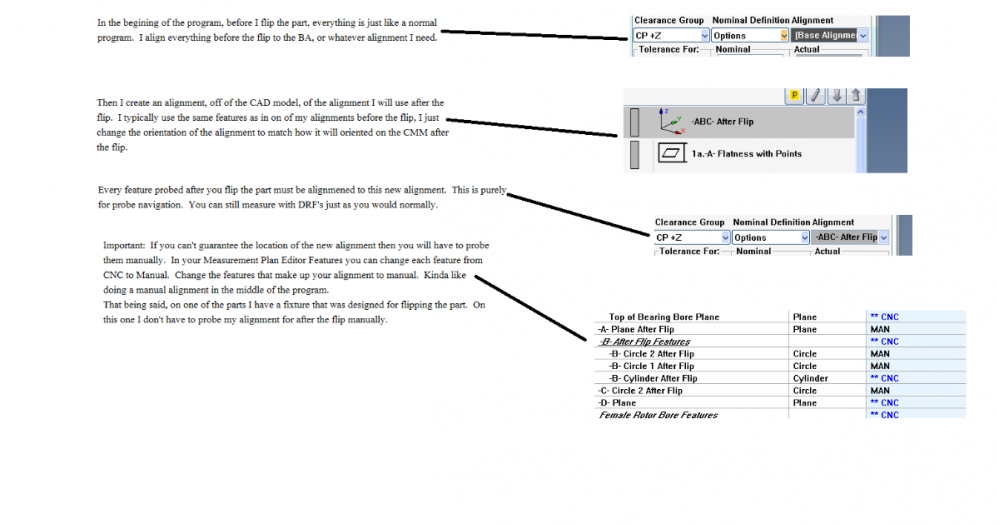

[Je...] Posted September 30, 2025 Share Posted September 30, 2025 Short term answer - write a separate inspection plan for this characteristics. Do not flip parts during inspection. Long term answer - Take CALYPSO EXPERT course to learn the 3 methods for achieving this workflow and which are most reliable. (hint: it definitely isn't flipping the part during inspection) 2 Link to comment https://qualityforum.zeiss.com/topic/24589-i-want-to-flip-my-part-in-order-to-capture-the-tp/#findComment-139241 Share on other sites More sharing options...
[Jo...] Posted October 7, 2025 Share Posted October 7, 2025 You can capture common alignment features between the two orientations and measure whatever you need. Check out page 3-60 in the calypso CNC manual. 2 Link to comment https://qualityforum.zeiss.com/topic/24589-i-want-to-flip-my-part-in-order-to-capture-the-tp/#findComment-139637 Share on other sites More sharing options...
[Ch...] Posted October 7, 2025 Share Posted October 7, 2025 While there are disadvantages, you can totally flip and part mid run and get good data. You can even use PCM to swap the CAD model to make it match the new flipped alignment. I attached some simple instructions. But like many things, there is more than one way to skin this cat. 2 Link to comment https://qualityforum.zeiss.com/topic/24589-i-want-to-flip-my-part-in-order-to-capture-the-tp/#findComment-139671 Share on other sites More sharing options...
