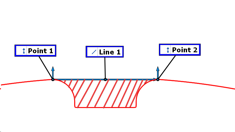

[Ma...] Posted September 29, 2025 Share Posted September 29, 2025 (edited) Good morning everyone, I need to measure the area of an irregular shape. I created a section, then defined two points and drew a line between them. Now I need to measure the area between them. Is it possible? Edited September 29, 2025 Link to comment https://qualityforum.zeiss.com/topic/24593-how-to-measure-an-area-of-a-irregular-shape/ Share on other sites More sharing options...

[Na...] Posted September 29, 2025 Share Posted September 29, 2025 Hi Marco, you can check a section directly for area. If it's not closed, the ends will be connected by a line in the background for the area calculation. So you could either create the section only for the marked area, or you create another Section -> Other -> Section from points. The selection for the section from points could be inside sphere with the center point of the sphere being the symmetry point from Point 1 and Point 2 for example. Nanno Link to comment https://qualityforum.zeiss.com/topic/24593-how-to-measure-an-area-of-a-irregular-shape/#findComment-139121 Share on other sites More sharing options...

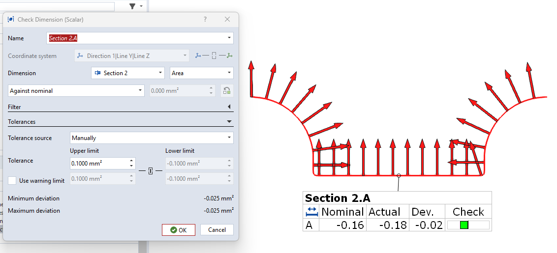

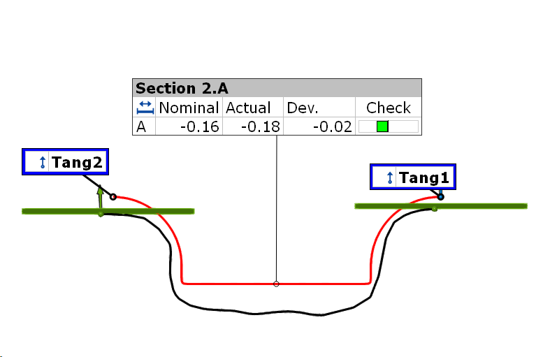

[Ma...] Posted September 30, 2025 Author Share Posted September 30, 2025 Hi Nanno! First of all thank you! Ok, with some trick I made what I want, but I think the area it's not good. Look at the image. Link to comment https://qualityforum.zeiss.com/topic/24593-how-to-measure-an-area-of-a-irregular-shape/#findComment-139189 Share on other sites More sharing options...
[Na...] Posted September 30, 2025 Share Posted September 30, 2025 It will display a negative value because the vectors of the section are directed from outer side to the inside. Or is the absolute value not plausible? You could check by Operations -> Sections -> Close Gap manually and check the resulting closed section. Link to comment https://qualityforum.zeiss.com/topic/24593-how-to-measure-an-area-of-a-irregular-shape/#findComment-139201 Share on other sites More sharing options...
[Ma...] Posted September 30, 2025 Author Share Posted September 30, 2025 This is the window with parameter I used: could it be that the direction of the normals are wrong? Because in the window the nominal value is 0.00. Could it be that if the nominal value, due to the wrong directions of the normals, is negative it display 0.00? Link to comment https://qualityforum.zeiss.com/topic/24593-how-to-measure-an-area-of-a-irregular-shape/#findComment-139203 Share on other sites More sharing options...

[Na...] Posted September 30, 2025 Share Posted September 30, 2025 The image is displayed for me. The greyed out value seems to happen in the check dialog, if the gap is quite large. After OK, the nominal value is calculated though as seen in the label. The negative sign is displayed because it's an enclosed area like an inner diameter compared to an outer diameter for example. Same would happen with volume checks. Link to comment https://qualityforum.zeiss.com/topic/24593-how-to-measure-an-area-of-a-irregular-shape/#findComment-139233 Share on other sites More sharing options...

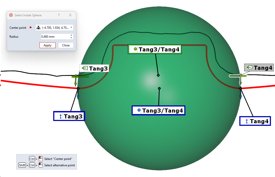

[Ma...] Posted October 13, 2025 Author Share Posted October 13, 2025 Hi Nanno! I understood all, exept about how to put the right value of the sphere selection, as in thw image. How can I put in the real radius value of the distance between Tang/3/Tang4 and Tang3 for the sphere selection? If I put the CAD value, then it don't select the value of the Tang3/Tang4 on the mesh.. I hope I explained myself. Link to comment https://qualityforum.zeiss.com/topic/24593-how-to-measure-an-area-of-a-irregular-shape/#findComment-140067 Share on other sites More sharing options...
[Na...] Posted October 14, 2025 Share Posted October 14, 2025 Hi Marco, "Select by curve" with both points as parameters for "Limit selection" should work. Or you construct a circle from the division point 3/4 and "Radius by point". The selection is "by geometry contour" using this circle: Link to comment https://qualityforum.zeiss.com/topic/24593-how-to-measure-an-area-of-a-irregular-shape/#findComment-140101 Share on other sites More sharing options...
