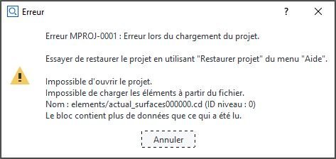

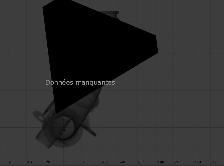

[Th...] Posted September 30, 2025 Share Posted September 30, 2025 (edited) Hi, I'm a bit puzzeled by this error message i just got while trying to make a video report page in my project. I'm working on zeiss inpect x-ray 2025. When I make a report page containing a video i get a message stating "missing data" on the report page. Note : this morning i had troubles to open my project and had to use the help menu to restore it. Seems like the file was too big to handle. i cleaned some data to lose some weight and everything is working fine in the project except this video issue... Edited September 30, 2025 Link to comment https://qualityforum.zeiss.com/topic/24607-missing-data-error-message-on-report-page-of-a-video/ Share on other sites More sharing options...
[Th...] Posted October 1, 2025 Author Share Posted October 1, 2025 (edited) Nevermind both of my problem solved. 1) Video error : For those who might wander, this issue was caused by actual elements required for the video that were not calculated, even though I used the "update all" button. I had to manually force update of all actual elements to make it work again. 2) Error MPROJ-0001 : Project was saved on local hard drive, no server issue involved. While making porosity analysis on plastic part, using the defect detection made too many results (arround 1400). Apparently it caused an overload of data in elements/actual_surfaces000000.cd that could not be read by the software when opening the project. That error caused data loss. Hopefully nothing too long to make again... There were no warnings from Zeiss inspect before closing the project. Hope this helps someone in the future because I couldn't find anything online. Edited October 1, 2025 1 Link to comment https://qualityforum.zeiss.com/topic/24607-missing-data-error-message-on-report-page-of-a-video/#findComment-139297 Share on other sites More sharing options...
