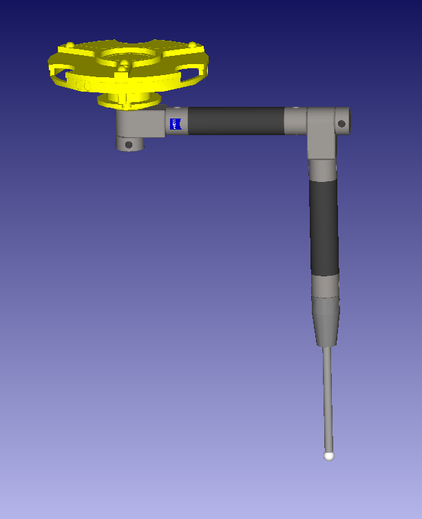

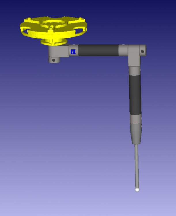

[na...] Posted October 1, 2025 Share Posted October 1, 2025 Please sign in to view this quote. Just an idea: Link to comment https://qualityforum.zeiss.com/topic/24615-measuring-something-bigger-than-the-table/#findComment-139283 Share on other sites More sharing options...
[Ed...] Posted October 1, 2025 Author Share Posted October 1, 2025 Please sign in to view this quote. Ah, I should have probably mentioned that I have to measure optically. These workpieces are about 0.5mm thick. Link to comment https://qualityforum.zeiss.com/topic/24615-measuring-something-bigger-than-the-table/#findComment-139285 Share on other sites More sharing options...
[na...] Posted October 1, 2025 Share Posted October 1, 2025 Please sign in to view this quote. Is rotating the part to fit diagonally an option? Or combining tactile and optical sensors? Link to comment https://qualityforum.zeiss.com/topic/24615-measuring-something-bigger-than-the-table/#findComment-139287 Share on other sites More sharing options...
