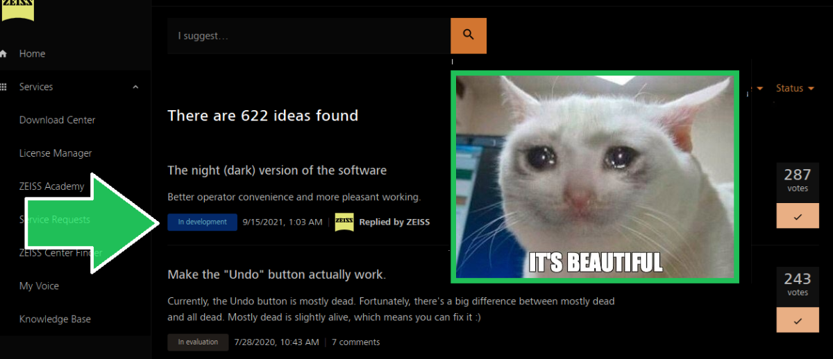

Popular Post [Je...] Posted October 7, 2025 Author Popular Post Share Posted October 7, 2025 (edited) Please sign in to view this username. , If you get this, please forward to your development team that is working on Dark Mode in Calypso: Many people are excited about Dark Mode, as it is the most voted-for idea on "My Voice." Because of this, I encourage you to see how other software implements Dark Mode. It's not simply about inverting the colors. Borrow from the best rather than develop in isolation. For example: 1. Dark Mode is usually not fully-black for the background. The sweet spot is usually somewhere close to: 25 Red, 25 Green, 25 Blue 2. Contrast and color are subtle but important refinements. Dark mode is not the same as "High Contrast." The reason many people flock to it is because of the ergonomic benefits, namely eye strain relief and faster recognition of on-screen elements (buttons, borders, scroll, etc.) 3. This is a fabulous opportunity to add color distinction and other needed refinements back into icons in Calypso. You're not admitting defeat--you're proving that listening to the Voice of the Customer matters to Zeiss. 4. There is no greater aspect to modern software design than the user experience, and GUI is a foundational contributor the user experience. It's not just about what your software can do... it's about how it does it. I appreciate all that you do for your user community, and I sincerely thank you. Edited October 7, 2025 6 Link to comment Share on other sites More sharing options...

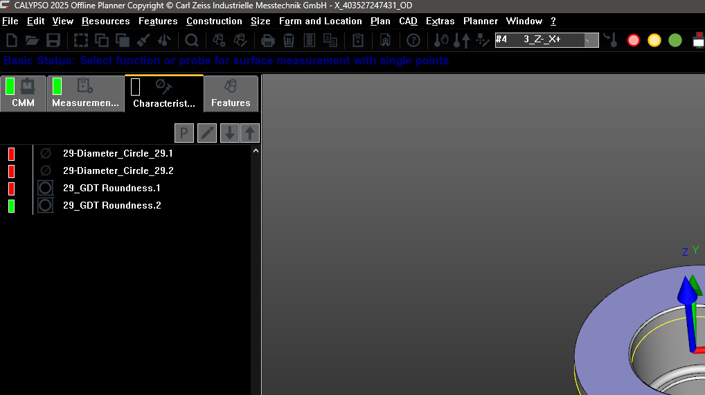

[Wo...] Posted October 10, 2025 Share Posted October 10, 2025 \ Please sign in to view this quote. Please sign in to view this quote. It works 😄 Forgive me for being an unbeliever, I repent. You can see it's WIP, but perfectly usable. Just a little bit more contrast on the icons and it will be perfect. Thank you! 2 Link to comment Share on other sites More sharing options...

Popular Post [Ch...] Posted October 10, 2025 Popular Post Share Posted October 10, 2025 Dark Mode=UI.Skins.SkinRegistry current isLightSkin ifTrue: [UI.Skins.SkinRegistry factoryMethodSelector: #emulatedWindowsDarkSkin] ifFalse: [UI.Skins.SkinRegistry factoryMethodSelector: #calypsoSkin]. Here it is if anyone wants to copy and paste it. 5 2 Link to comment Share on other sites More sharing options...
