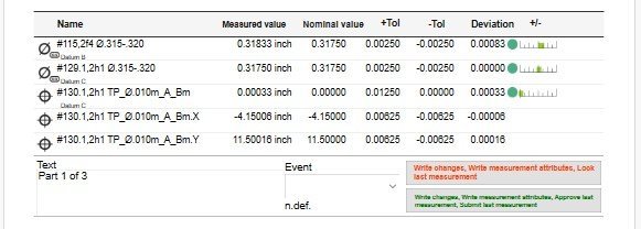

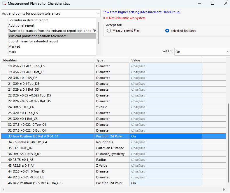

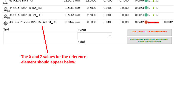

[Ma...] Posted October 2, 2025 Share Posted October 2, 2025 Hi Guys, Do you perhaps know how to show the position values of a given element (e.g., X and Y values) in the report when measuring position? I’m looking for a quick method to enable this function for all positions in the program. Even after enabling the option as shown below, the position values still do not appear in the report. I remember using this function a few years ago and it worked Link to comment https://qualityforum.zeiss.com/topic/24639-axis-end-points-for-position-tolerances/ Share on other sites More sharing options...

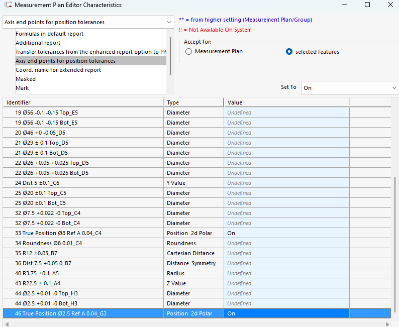

[Cr...] Posted October 2, 2025 Share Posted October 2, 2025 (edited) In the same window that you're in, go to additional report and turn that on. Edited October 2, 2025 1 Link to comment https://qualityforum.zeiss.com/topic/24639-axis-end-points-for-position-tolerances/#findComment-139419 Share on other sites More sharing options...
[Ma...] Posted October 2, 2025 Author Share Posted October 2, 2025 Please sign in to view this quote. That's exactly what I meant. Great. Thanks a lot! 🙂 Link to comment https://qualityforum.zeiss.com/topic/24639-axis-end-points-for-position-tolerances/#findComment-139431 Share on other sites More sharing options...

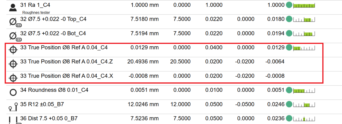

[Ma...] Posted October 2, 2025 Author Share Posted October 2, 2025 Please sign in to view this quote. Below is an example of its use. For a given position, you have the deviations of the element listed for each axis. A useful — even essential — function for CNC programmers when adjusting parameters Link to comment https://qualityforum.zeiss.com/topic/24639-axis-end-points-for-position-tolerances/#findComment-139445 Share on other sites More sharing options...

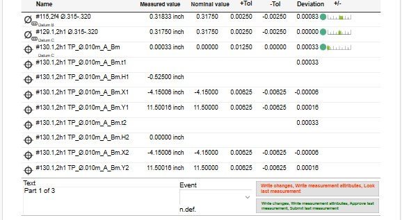

[Ri...] Posted October 6, 2025 Share Posted October 6, 2025 Additional Report vs Axis Endpoints. Additional Report will show you the Coordinates of the True Position, using Axis Endpoints will show you deviations of the feature axis for those coordinates. The first image is Additional Report enabled. The Second image is Additional Report enabled, and Axis Endpoints enabled. Link to comment https://qualityforum.zeiss.com/topic/24639-axis-end-points-for-position-tolerances/#findComment-139559 Share on other sites More sharing options...
