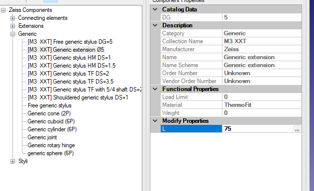

[Na...] Posted October 2, 2025 Share Posted October 2, 2025 I'm trying to configure all of my Stylus in the Creator but its not showing the 75mm extension. Is there a place where I can the scl or prb file to add it? Link to comment https://qualityforum.zeiss.com/topic/24649-75mm-extension-scc/ Share on other sites More sharing options...
[Cr...] Posted October 2, 2025 Share Posted October 2, 2025 You can create a generic extension under that dropdown and clicking the 3 dots on the modify properties section. 2 Link to comment https://qualityforum.zeiss.com/topic/24649-75mm-extension-scc/#findComment-139453 Share on other sites More sharing options...
[Ri...] Posted October 3, 2025 Share Posted October 3, 2025 You can use a 35 and a 40. Im not sure if there is a 75, all of mine are 80. Link to comment https://qualityforum.zeiss.com/topic/24649-75mm-extension-scc/#findComment-139477 Share on other sites More sharing options...
