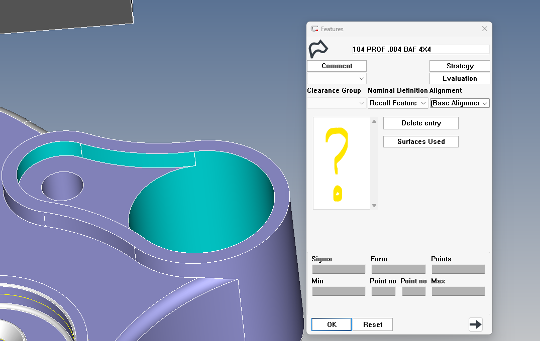

[Pe...] Posted October 3, 2025 Share Posted October 3, 2025 Is there a setting that shows these surfaces that I have turned off somewhere? In my other planners it works fine and I see the list of faces, but this particular seat I dont. Link to comment https://qualityforum.zeiss.com/topic/24657-show-surfaces-used-in-a-freeform-surface/ Share on other sites More sharing options...
[Ma...] Posted October 4, 2025 Share Posted October 4, 2025 You have an empty list, so in this case you have selected nothing. If you have strategy in this feature, then you can click on button "Surfaces used" to auto select - if you just recalled mesured points, then it won't select anything. Link to comment https://qualityforum.zeiss.com/topic/24657-show-surfaces-used-in-a-freeform-surface/#findComment-139517 Share on other sites More sharing options...
[Pe...] Posted October 7, 2025 Author Share Posted October 7, 2025 Please sign in to view this quote. I first make the feature then I manually clicked on the surfaces which it shows highlighted in the above screenshot to select them. Then I use recall feature points. I have in the past done exactly this and I see the names from the cad (e.g. "entity 523 3"). But now it doesnt seem to populate the list with the names even though it does highlight the surfaces when I select my FF surface. In the grand scheme of things its not a necessary thing to have but just annoying that it displayed once, but after updating it no longer does. And I am wondering if anyone who has a similar version of calypso (2024 sp3) also has the same issue. Link to comment https://qualityforum.zeiss.com/topic/24657-show-surfaces-used-in-a-freeform-surface/#findComment-139645 Share on other sites More sharing options...
