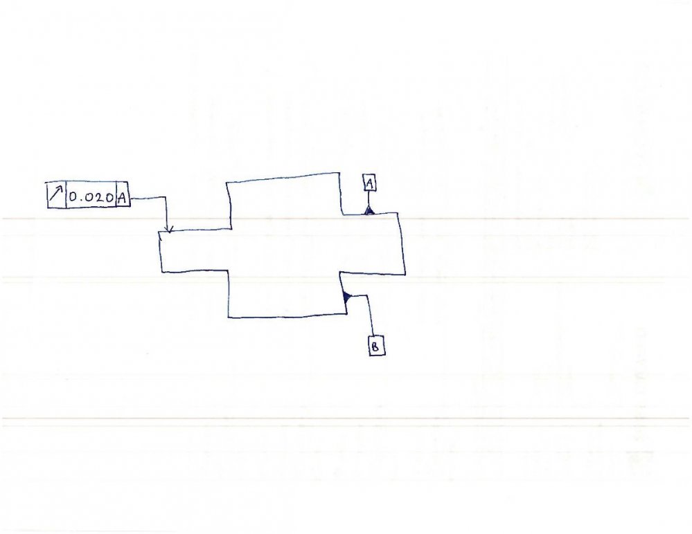

[Wi...] Posted October 6, 2025 Share Posted October 6, 2025 I've got a Zeiss Micura with a VAST XT Gold head. I have a part that is a shaft with a runout tolerance in which the datum is on the opposite side, and therefore not able to measure from one side. The solution was to turn the part on its side and use a star probe. The issue is, the star probe varies like nothing I've ever seen. I'll run the same part 3 times, it is always .100mm+ runout, and then after drop to .005 - .030 for the subsequent runs. Star probe is using 1.5mm probes with roughly 30mm shaft length. Qualification is done at 45 degrees so 2 of the 4 probes on the flat plane can be qualified, then it is rotated, master probe is qualified at the new location, and the remaining two probes are measured. Link to comment https://qualityforum.zeiss.com/topic/24671-measuring-runout-using-star-probe/ Share on other sites More sharing options...

[Wi...] Posted October 6, 2025 Author Share Posted October 6, 2025 Please sign in to view this quote. I attached an image that describes it a bit. Datum B is being used for the spatial orientation. It is the largest plane on the part Link to comment https://qualityforum.zeiss.com/topic/24671-measuring-runout-using-star-probe/#findComment-139591 Share on other sites More sharing options...
[DW...] Posted October 6, 2025 Share Posted October 6, 2025 Please sign in to view this quote. Please sign in to view this username. Try this - Create a circle on A, and a circle opposite A. Recall both circles into a 3d line. Set the spatial to the correct axis of the 3d line. Any improvements? 1 Link to comment https://qualityforum.zeiss.com/topic/24671-measuring-runout-using-star-probe/#findComment-139593 Share on other sites More sharing options...
[Ma...] Posted October 6, 2025 Share Posted October 6, 2025 There should be only cylinder A used as a datum. It's runout on cylinder, but only a circle - total runout would be with whole cylinder - i am not sure how Calypso interpret this. 1 Link to comment https://qualityforum.zeiss.com/topic/24671-measuring-runout-using-star-probe/#findComment-139601 Share on other sites More sharing options...
[Ky...] Posted October 6, 2025 Share Posted October 6, 2025 Another question would be "what is the ratio of the diameter of A to the length that you can measure?". If the diameter isn't significantly smaller than the length you can measure, it will not work very well for a datum. Link to comment https://qualityforum.zeiss.com/topic/24671-measuring-runout-using-star-probe/#findComment-139605 Share on other sites More sharing options...
[Ke...] Posted October 7, 2025 Share Posted October 7, 2025 Please sign in to view this quote. If you are not, already: loop your base alignment. Also, report the form for all of your runout features, so you can see any deviations that might be affecting your results (and if they change from run to run) Link to comment https://qualityforum.zeiss.com/topic/24671-measuring-runout-using-star-probe/#findComment-139625 Share on other sites More sharing options...
[Jo...] Posted October 8, 2025 Share Posted October 8, 2025 Are you qualifying on an appropriately sized reference sphere? We get lower sigma when qualifying on 8mm ref balls on probes smaller than about 1.5mm Link to comment https://qualityforum.zeiss.com/topic/24671-measuring-runout-using-star-probe/#findComment-139751 Share on other sites More sharing options...
