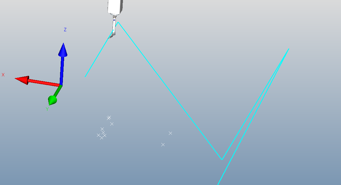

[Ro...] Posted October 7, 2025 Share Posted October 7, 2025 Hey guys, When I use positionCMM together with getPositionCMM(), for example: positionCMM(getPositionCMM().x, getPositionCMM().y, -5) I’m running into a really strange bug. Instead of just moving up along the Z-axis, the machine starts flying all over the place. This only happens right after starting the program, when the first of those commands is executed. If it somehow doesn’t crash and the program keeps running, the next time I call this function it behaves as expected and just goes up. This is happening in simulation and live on the machine. I’ve attached a picture showing what happens. The machine is only supposed to move upward. Is there an alternative PCM method to move the machine along just one axis? Link to comment https://qualityforum.zeiss.com/topic/24675-strange-behaviour-of-positioncmm/ Share on other sites More sharing options...

[Ro...] Posted October 8, 2025 Author Share Posted October 8, 2025 The command and its inputs are based on the machine coordinate system, so i think it should not matter. And it happens a good while after the base alignment has been established... I might have worded the "right after starting the program" wrong. For example, if i stop the program with the red light and start it again with existing alignment there is no problem 1 Link to comment https://qualityforum.zeiss.com/topic/24675-strange-behaviour-of-positioncmm/#findComment-139699 Share on other sites More sharing options...

[Pi...] Posted June 9 Share Posted June 9 full code looks like this: positionCMM(5,-5,-5,"Z","Y","X") values are for X Y Z in this order letters are order for execution - first CMM will go to -5 in Z then to -5 in Y then to +5 in X Link to comment https://qualityforum.zeiss.com/topic/24675-strange-behaviour-of-positioncmm/#findComment-151608 Share on other sites More sharing options...
