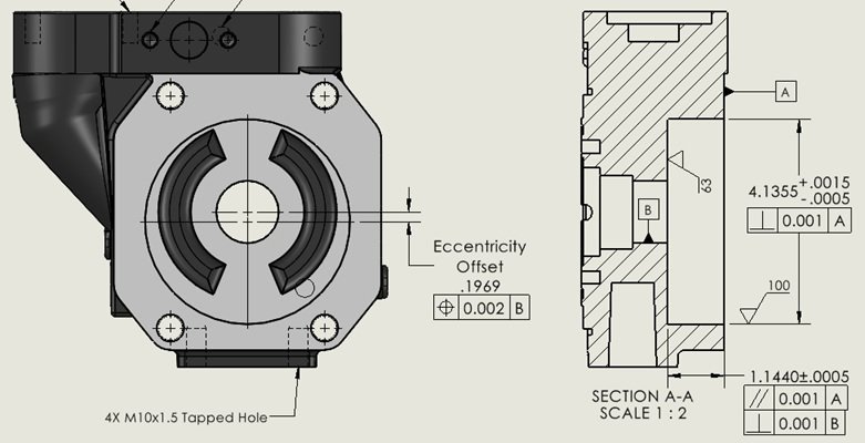

[Ow...] Posted October 7, 2025 Share Posted October 7, 2025 Everything is in inch units. The big bore 4.1355 (Gerotor bore) is a direct offset in the Y axis. How would you constrain/clock this with only the 0.1969 offset as the planar axis and get good repeatability? I’ve tried measuring the middle bore as a cylinder and constructing a 3D line to intersect with the bottom of the 1.440 face and then the 4.1355 cylinder the same way intersecting with the same face and then creating a line between the two intersects for planar, but the offset always shows the x axis off one way or the other (non -repeatable), which effects the offset dimension. Each Cylinder is being measured with 3 equally spaced circle paths and then recalled into a 3D line. The alignment is looped. Link to comment https://qualityforum.zeiss.com/topic/24681-offset-of-bore-with-no-planar-axis/ Share on other sites More sharing options...
[Cl...] Posted October 7, 2025 Share Posted October 7, 2025 I recently had a very similar situation. I ended up measuring two circles. One near the top (-A-) and the other near the bottom of the 4.1355 cylinder and constructing my 3d line that way (Z Spatial). I ended up passing a type-1 GRR <20%. As far as the planar clocking goes. I don't see a tertiary datum? Could you simply translate by .1969 1 Link to comment https://qualityforum.zeiss.com/topic/24681-offset-of-bore-with-no-planar-axis/#findComment-139631 Share on other sites More sharing options...

[Cl...] Posted October 7, 2025 Share Posted October 7, 2025 Maybe I misunderstood that callout. With no tertiary datum. I'm not sure how I' clock it. 1 Link to comment https://qualityforum.zeiss.com/topic/24681-offset-of-bore-with-no-planar-axis/#findComment-139659 Share on other sites More sharing options...
[Ri...] Posted October 7, 2025 Share Posted October 7, 2025 (edited) See that "Cross Hair"? According to ASME Y14.5, that is an implied 90°. Your offset is 90° from its shown dimension. The controls for datums A and B control the 90°. ASME Y14.5 2009 Please sign in to view this quote. Edited October 7, 2025 1 Link to comment https://qualityforum.zeiss.com/topic/24681-offset-of-bore-with-no-planar-axis/#findComment-139667 Share on other sites More sharing options...
[Cl...] Posted October 7, 2025 Share Posted October 7, 2025 You need to clock something. Create a theoretical line through Ø -B-. Intersect that line with Ø -A- for a point (X+) Planar rotate about Z -5.44°. (If my math is right) using that intersected point. 1 Link to comment https://qualityforum.zeiss.com/topic/24681-offset-of-bore-with-no-planar-axis/#findComment-139669 Share on other sites More sharing options...
[Ja...] Posted October 7, 2025 Share Posted October 7, 2025 Recall one of the circle paths of the eccentric bore cylinder to a circle feature and clock to that circle. Another way would be to create a secondary alignment using DATUM B for spatial, x and y origin. Use this secondary alignment to create a geometry best fit alignment for the eccentric bore cylinder and allow rotation around Z axis. Use this GBF alignment for location characteristics. 2 Link to comment https://qualityforum.zeiss.com/topic/24681-offset-of-bore-with-no-planar-axis/#findComment-139683 Share on other sites More sharing options...
[Ow...] Posted October 7, 2025 Author Share Posted October 7, 2025 You all going to hate me, but I finally got back on it and..... the (*#&$@) part was moving :-(. I am using the line recalled between the intersections for planar. I do appreciate all of the replies and ideals. Link to comment https://qualityforum.zeiss.com/topic/24681-offset-of-bore-with-no-planar-axis/#findComment-139691 Share on other sites More sharing options...
