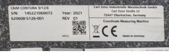

[Je...] Posted October 15, 2025 Share Posted October 15, 2025 What is the SN of your CMM? Lets see what we can do from the US side for you. Link to comment https://qualityforum.zeiss.com/topic/24701-how-can-i-restore-my-calypso-license/#findComment-140227 Share on other sites More sharing options...
[Mi...] Posted October 16, 2025 Author Share Posted October 16, 2025 (edited) Please sign in to view this quote. Edited October 16, 2025 Link to comment https://qualityforum.zeiss.com/topic/24701-how-can-i-restore-my-calypso-license/#findComment-140277 Share on other sites More sharing options...
[Mi...] Posted October 20, 2025 Author Share Posted October 20, 2025 Please sign in to view this quote. Hello, Jeffrey! Just in case, I'll duplicate the text, and the photo turned out to be kind of fuzzy! CMM sn: 145221060073 Link to comment https://qualityforum.zeiss.com/topic/24701-how-can-i-restore-my-calypso-license/#findComment-140417 Share on other sites More sharing options...
