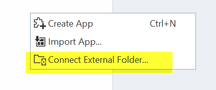

[De...] Posted October 21, 2025 Share Posted October 21, 2025 I too had a similar issue & remember banging my head against the wall for a solid day. I'm not exactly sure what I did that fixed it but I tried a combination of [Switching to Absolute Imports, creating an empty __init__.py in the main scripts folder, adding the path to system path like you did (but you shouldn't have todo this) ] . since then I've had the most success by using absolute imports (eg. from Folder1.Folder2.Script1 import something) You can also try using an external folder, this always keeps the app in edit mode. hope it helps. Link to comment https://qualityforum.zeiss.com/topic/24713-script-issue-when-i-finalize-app/#findComment-140497 Share on other sites More sharing options...
