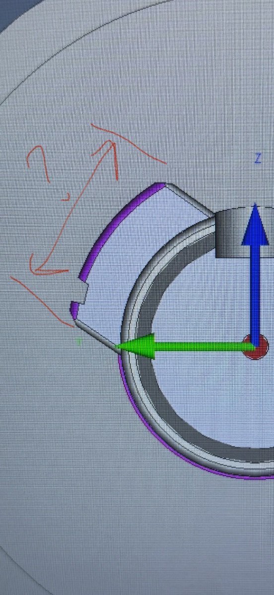

[Ch...] Posted October 9, 2025 Share Posted October 9, 2025 Hey guys I’m pretty new to calypso and zeiss and self taught so far. But I’m working on a program and I want to measure the distance between these two planes. The planes are parallel to each other but at an angle from the setup. I figured a simple caliper distance would work but it doesn’t give the correct measurement. Any help would be greatly appreciated.. Link to comment Share on other sites More sharing options...
[Lu...] Posted October 10, 2025 Share Posted October 10, 2025 Results are incorrect by how much? This might tell where to look Link to comment Share on other sites More sharing options...
[Ma...] Posted October 10, 2025 Share Posted October 10, 2025 Cartesian distance or you have to make rotated alignment to be used with caliper distance ( to make it squared ) Link to comment Share on other sites More sharing options...
[Ke...] Posted October 10, 2025 Share Posted October 10, 2025 Feature -> Symmetry Plane would also work for this. Then you can evaluate at Outer Tangential, as well. Link to comment Share on other sites More sharing options...
[Pa...] Posted October 12, 2025 Share Posted October 12, 2025 I'd go the Symmetry Plane route, but Martin hints at a cool "trick". Create a secondary alignment. Hit the "special" button. Input the angle of your feature (obviously be mindful of axis and direction) and watch the trihedron align to your feature. Presto- you can now use your caliper distance or any other evaluation. Bonus points: When creating a pattern isn't desirable you can use this alignment combined with "keep position" to create multiple repeating features quickly. Works for offsets in each axis too. Play with it a bit. You're gonna like this one! Link to comment Share on other sites More sharing options...
