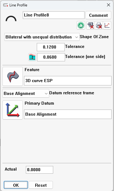

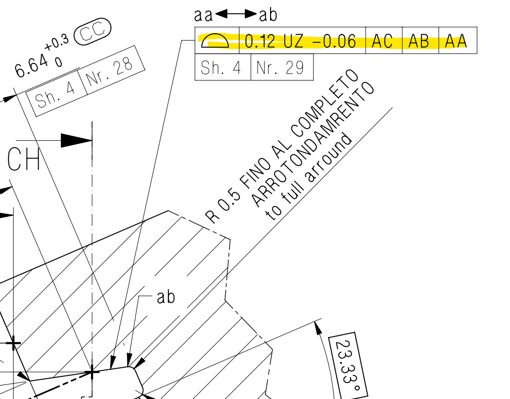

[Da...] Posted October 13, 2025 Share Posted October 13, 2025 Hi everyone, Today, for the first time, I need to implement an asymmetric tolerance zone in a profile control. I understand that the designer wants to shift the nominal surface 0.06 mm inside the part and then apply a symmetric bilateral tolerance of 0.12 mm. Do you think the implementation I chose is correct? Link to comment https://qualityforum.zeiss.com/topic/24727-profile-and-asymetric-tollerance-zone-question/ Share on other sites More sharing options...

[Ri...] Posted October 13, 2025 Share Posted October 13, 2025 It would be set with the Tolerance of 0.12, the Tolerance (one side) of 0, and the Direction to outside. If you have 2025, the new GD&T natively handles the UZ with no need to do the math. 🙂 Link to comment https://qualityforum.zeiss.com/topic/24727-profile-and-asymetric-tollerance-zone-question/#findComment-140059 Share on other sites More sharing options...
[Da...] Posted October 13, 2025 Author Share Posted October 13, 2025 Please sign in to view this quote. Good to know, I hope my company updates to version 2025 soon. Thank you! Link to comment https://qualityforum.zeiss.com/topic/24727-profile-and-asymetric-tollerance-zone-question/#findComment-140063 Share on other sites More sharing options...
