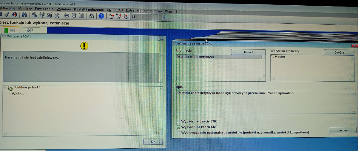

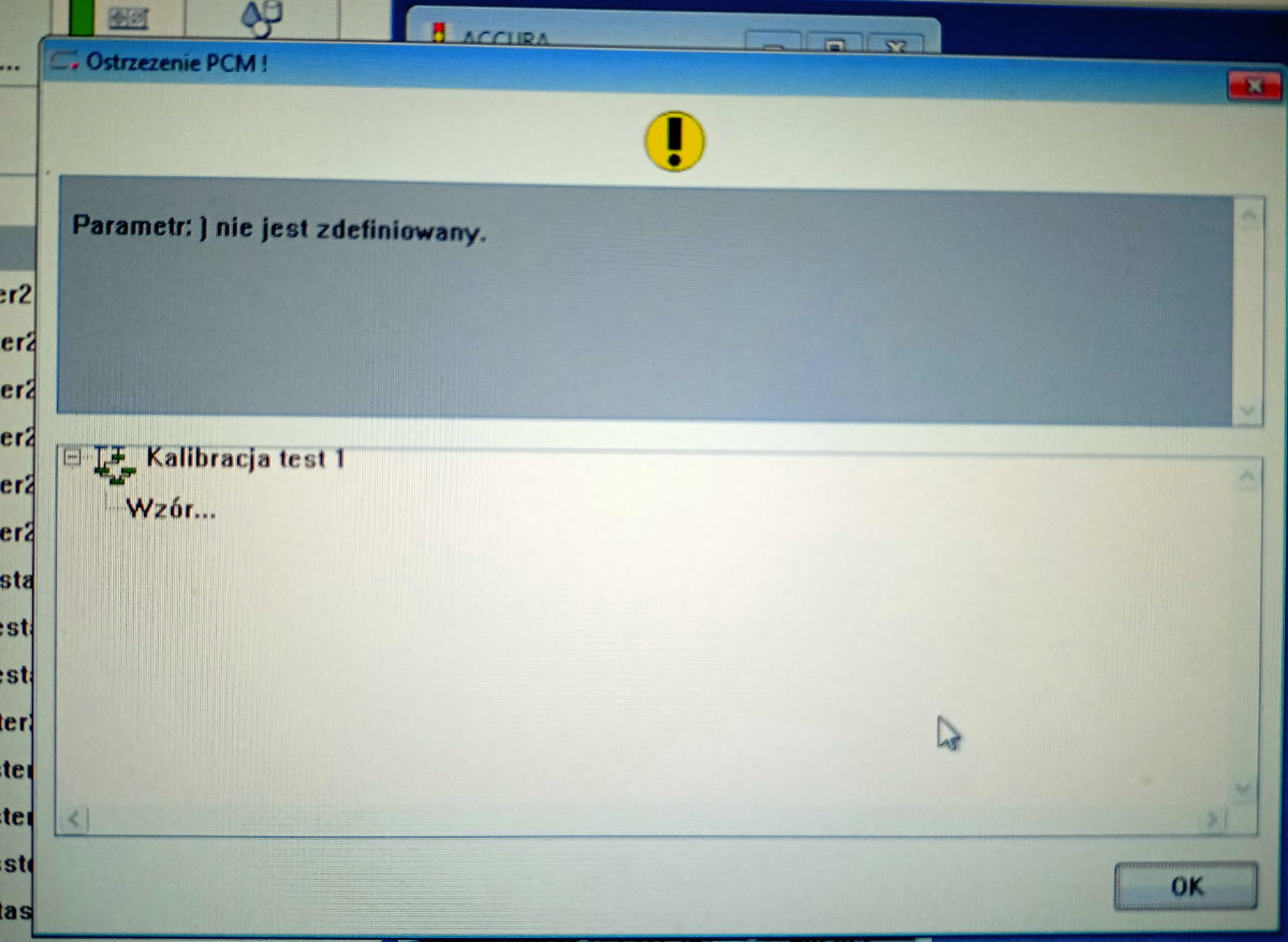

[Da...] Posted October 13, 2025 Share Posted October 13, 2025 (edited) We are having two Accura's with Calypso from 2014, helios, and PCM And there are some issues. After runing calibration program after runing each qualification there are problems like here on photos. It stops qualification and require us to run every stylus system independently instead of just "click play" My friend told me we have lots of PCM functionality but we have no PCM training and we just runing programs here. Any ideas what may be reason of this software behavior and how to solve it ? it also appears in newly created program, so it seems it should be something in Calypso New program runs on alignment this way: Second question i dlike to ask for help is the old qualification program we can freely run from autorun for operators, we just put the sphere on its location. The location is not super solid it can move like +/- 1.5mm but program works and calibration is going on. Is it corect way ? I mean normally i need to show manually top point of sphere so Calypso can find its position, or it should be in exact the same position. This program have sphere in and alignment, and if i make reference sphere position before its ignoring it and going to some "old" position. Is this aligning made for leting it reference it by itself without help of human ? Edited October 13, 2025 Link to comment https://qualityforum.zeiss.com/topic/24729-probe-qualification-issue-pcm-refefence-probe-position/ Share on other sites More sharing options...

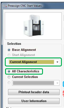

[Sv...] Posted October 13, 2025 Share Posted October 13, 2025 In the startup parameters, the movement between measurement elements must be set from automatic to no generation. This should still be checked. Link to comment https://qualityforum.zeiss.com/topic/24729-probe-qualification-issue-pcm-refefence-probe-position/#findComment-140047 Share on other sites More sharing options...

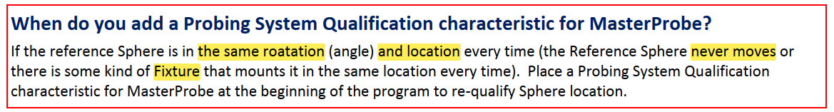

[Ke...] Posted October 13, 2025 Share Posted October 13, 2025 With regards to the old calibration program, when you say it is not solid and can move, do you mean it can move during the measurement program or the location varies when the sphere is removed and replaced? And does the system pick up the Masterprobe and touch on the reference sphere automatically? Link to comment https://qualityforum.zeiss.com/topic/24729-probe-qualification-issue-pcm-refefence-probe-position/#findComment-140065 Share on other sites More sharing options...
[Da...] Posted October 14, 2025 Author Share Posted October 14, 2025 Please sign in to view this quote. will check it, thank you now i think it was on auto Please sign in to view this quote. Its solid when i place it, but after mounting, puting back on place and measuring again its position is not even close to 0. Its interesting for me because in Pc-problem and quindos i allways have to show its position manually, at least its my actiual knowledge Link to comment https://qualityforum.zeiss.com/topic/24729-probe-qualification-issue-pcm-refefence-probe-position/#findComment-140089 Share on other sites More sharing options...
[Ke...] Posted October 14, 2025 Share Posted October 14, 2025 If the program automatically picks up the Masterprobe and touches the reference sphere first, and the sphere is close enough to the last known or nominal location depending how the program is written ( I do not have an official specification of "close enough" on hand), then the program will find the location of the reference sphere and update it in the same way it would if you taught the location manually. If it is too far off, I have never heard of a case of it managing to run the program, it will crash on the masterprobe portion. 1 Link to comment https://qualityforum.zeiss.com/topic/24729-probe-qualification-issue-pcm-refefence-probe-position/#findComment-140139 Share on other sites More sharing options...
[Da...] Posted November 3, 2025 Author Share Posted November 3, 2025 super ! thank you. I was learned to never do CNC run on masterprobe, so i thinked its something wrong with it. Any ideas about this window ? it is in every new program it appears beetween all probes to calibration, so we cannot use autorun for calibration: Link to comment https://qualityforum.zeiss.com/topic/24729-probe-qualification-issue-pcm-refefence-probe-position/#findComment-141317 Share on other sites More sharing options...
