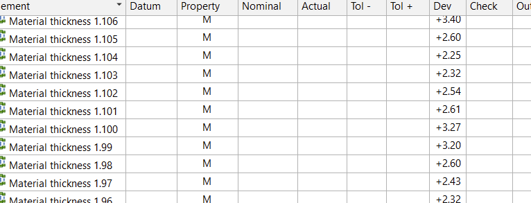

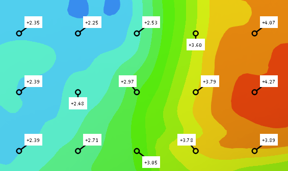

[Fr...] Posted October 16, 2025 Share Posted October 16, 2025 Dear ZEISS-GOM user community, is there a way to export a CSV file with X,Y,Z coordinates and values of an equidistant deviation label grid created from a thickness analysis? I can make a table but it misses the coordinates: thanks f Link to comment https://qualityforum.zeiss.com/topic/24773-exporting-equidistant-deviation-labels-thickness-as-csv-in-gom-inspect-2019/ Share on other sites More sharing options...
[Ma...] Posted October 16, 2025 Share Posted October 16, 2025 (edited) You can go to Menu File -> Export -> Geometry -> CSV - select your points - if you add dimensions XYZ for those points you will have actuals in exported CSV Only selected geometries will be exported A question: i am beggining with Inspect so i have created Surface points and used one by one on Create material thickness inspection point. Do you have to do it one by one or you can select many on one go ( to create many single ones ) Or if i did it wrong, then post how to achieve equidistant flags like on your picture Edited October 16, 2025 Link to comment https://qualityforum.zeiss.com/topic/24773-exporting-equidistant-deviation-labels-thickness-as-csv-in-gom-inspect-2019/#findComment-140317 Share on other sites More sharing options...

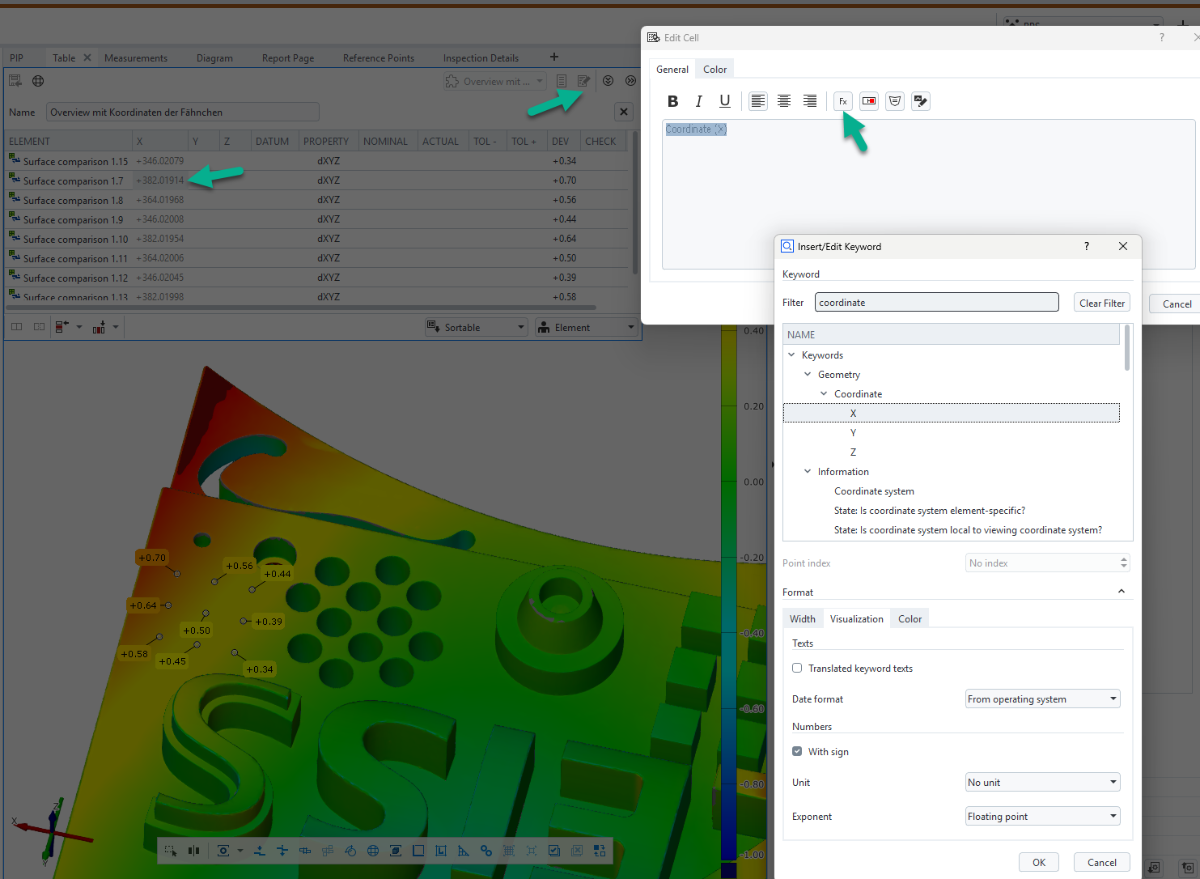

[Na...] Posted October 17, 2025 Share Posted October 17, 2025 Please sign in to view this quote. Hi, you could create the surface points first, for example as equidistant surface points -> select them all -> use this: https://techguide.zeiss.com/en/zeiss-inspect-2025/article/cmd_inspection_check_material_thickness_at_points.html Or you create the material thickness as a surface inspection: https://techguide.zeiss.com/en/zeiss-inspect-2025/article/cmd_comparison_create_multiple_material_thickness.html Please sign in to view this quote. You need to switch the table into "edit" -> add columns -> insert keyword for coordinate into the columns. Here is an example for X-coordinate: 2 Link to comment https://qualityforum.zeiss.com/topic/24773-exporting-equidistant-deviation-labels-thickness-as-csv-in-gom-inspect-2019/#findComment-140359 Share on other sites More sharing options...
[Ma...] Posted October 17, 2025 Share Posted October 17, 2025 Please sign in to view this username. thanks - i was missing that option ( could not find that, looking at wrong spot ) Link to comment https://qualityforum.zeiss.com/topic/24773-exporting-equidistant-deviation-labels-thickness-as-csv-in-gom-inspect-2019/#findComment-140363 Share on other sites More sharing options...
