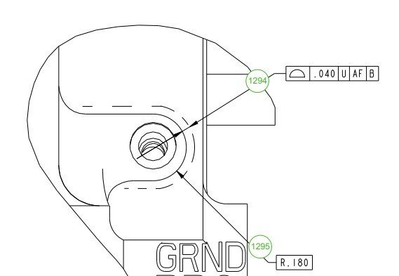

[Ri...] Posted October 17, 2025 Share Posted October 17, 2025 (edited) I could use a clarification of this profile. (See attached image). I believe it means the profile should be outward as shown with the arrows, Unilateral (Nominal contour outside) and it is all around as shown. I am quite sure that ASME Y14.5 1994 allows this while 2009 requires a "U" modifier. Any assistance is appreciated. Edited October 17, 2025 Link to comment https://qualityforum.zeiss.com/topic/24785-gdt-profile-on-bp-shows-a-boundary-line-outward-ref-asme-y145-1994/ Share on other sites More sharing options...
[Ma...] Posted October 18, 2025 Share Posted October 18, 2025 I think you found an answer from posted image from one of my posts. I don't know if it's valid with dashed line, but it looks like for newer ASME you would need (U). Tolerance is shown on graphics, but without model i woud doubt if it's inward or outward ( if it's correct callout by engineer ) Link to comment https://qualityforum.zeiss.com/topic/24785-gdt-profile-on-bp-shows-a-boundary-line-outward-ref-asme-y145-1994/#findComment-140407 Share on other sites More sharing options...
[Ri...] Posted October 21, 2025 Author Share Posted October 21, 2025 That line is a phantom line in ASME Y14.100M. Dashed is much different, similar to this"-------". Link to comment https://qualityforum.zeiss.com/topic/24785-gdt-profile-on-bp-shows-a-boundary-line-outward-ref-asme-y145-1994/#findComment-140513 Share on other sites More sharing options...
[Ri...] Posted October 22, 2025 Share Posted October 22, 2025 I would interpret it as a 0.040 will all of the tolerance on the outside. Link to comment https://qualityforum.zeiss.com/topic/24785-gdt-profile-on-bp-shows-a-boundary-line-outward-ref-asme-y145-1994/#findComment-140623 Share on other sites More sharing options...
[Wo...] Posted October 23, 2025 Share Posted October 23, 2025 I think theoretically there should be a single arrow to the phantom line, not two from basic to phantom, but other than that I would agree with all tolerance on the outside. And also "balloon number 1295" yikes - the highest I've had was 1594 and that a fun two weeks of programming 😜 Link to comment https://qualityforum.zeiss.com/topic/24785-gdt-profile-on-bp-shows-a-boundary-line-outward-ref-asme-y145-1994/#findComment-140705 Share on other sites More sharing options...
