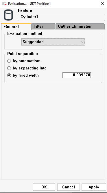

[Ja...] Posted October 17, 2025 Share Posted October 17, 2025 Can somebody point me to some documentation that explains this page 1 Link to comment https://qualityforum.zeiss.com/topic/24787-documentation-needed/ Share on other sites More sharing options...

[Ri...] Posted October 20, 2025 Share Posted October 20, 2025 Please sign in to view this username. I would suggest watching this. https://portal.zeiss.com/iqr-academy/video/9ayqSvFT_CphtrEwZ-7yq- Starts around 16 minutes in. Essentially it controls how the actual data from the feature is subdivided, usually in the case of a form control. It is suggested to turn on the CAD evaluation, and changing the fixed width to see the impact of the changes. Some characteristics this setting will have either minimal or no impact. 2 Link to comment https://qualityforum.zeiss.com/topic/24787-documentation-needed/#findComment-140479 Share on other sites More sharing options...
[Ja...] Posted October 21, 2025 Author Share Posted October 21, 2025 Thanks Richard. Interesting concept. That definitely has potential here. Unfortunately they don't tell you how the characteristic is being calculated if you choose "By Automatism". Logic would have me think it doesn't section the feature at all and uses all of the points. I can see where you're coming from. The more precision the feature is (IE: Jig grinding, surface grinding, etc.) we're probably not going to see a whole lot of difference. Link to comment https://qualityforum.zeiss.com/topic/24787-documentation-needed/#findComment-140529 Share on other sites More sharing options...
