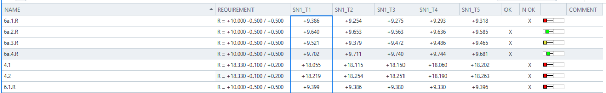

[Ma...] Posted October 18, 2025 Share Posted October 18, 2025 Hi, i am looking for solution. We would like to have a report page with 5 columns for 5 stages aka 5 measured parts, but i can not find a way to select dimension result for specific stage. Is something like that possible? I mean, there should be a way because there is a trend view. Thanks Link to comment https://qualityforum.zeiss.com/topic/24795-get-result_dimension-on-report-from-all-stages/ Share on other sites More sharing options...

[Ma...] Posted October 20, 2025 Author Share Posted October 20, 2025 Please sign in to view this username. Hi, initialy this was posted in Inspect section. We are measuring N of parts as first samples and we are using report style with dimension and tolerances on beginning of a row and then up to 5 columns for actuals. I tried using stages to obtain such report, but i can not get actual from specific stage. I know you how to get that from python but i didn't find how to place a python function into report column. Any ideas? Link to comment https://qualityforum.zeiss.com/topic/24795-get-result_dimension-on-report-from-all-stages/#findComment-140483 Share on other sites More sharing options...

[Jo...] Posted October 22, 2025 Share Posted October 22, 2025 (edited) I am not sure i get your problem right. So you want something like the following? SN1_T1 to SN1_T5 being the 5 stages in the project. For your export demands this article might help. https://techguide.zeiss.com/en/zeiss-inspect-2025/article/how_to_export_table_data_from_different_stages_in_one_file.html Edited October 22, 2025 Link to comment https://qualityforum.zeiss.com/topic/24795-get-result_dimension-on-report-from-all-stages/#findComment-140615 Share on other sites More sharing options...
[Ma...] Posted October 22, 2025 Author Share Posted October 22, 2025 Please sign in to view this username. Yes, your posted image is what i would like to have, but i can not get results ( numbers in SN1_T1, T2, ... ) into the table. I am not sure what i am doing wrong, i still get only active result. Unfortunately, posted article didn't help. Those steps are done, but only one stage shown. Link to comment https://qualityforum.zeiss.com/topic/24795-get-result_dimension-on-report-from-all-stages/#findComment-140629 Share on other sites More sharing options...
[Jo...] Posted October 23, 2025 Share Posted October 23, 2025 (edited) edit any template. I usually start with the VDA-template. lmb into the actual column and switch on "column per stage". The actual column should be greyed out to show this. Double click in the header -> FX -> search for stage -> and choose stage name or something. In german it is "anzeigename". Should be working now. In the cells for the values you got: "$scalar_value == INVALID or result_dimension.is_vectorial?"":format(result_dimension.measured_value, "+", show_unit=false)$". But this is done automatically. I just had to the the 3 steps above. Edited October 23, 2025 1 Link to comment https://qualityforum.zeiss.com/topic/24795-get-result_dimension-on-report-from-all-stages/#findComment-140695 Share on other sites More sharing options...
[Ma...] Posted October 23, 2025 Author Share Posted October 23, 2025 Please sign in to view this username. Ah thanks - i just found that "column per stage" - now it's working. It wasn't obvious at editing template, but on real report page it was showing. It is automatically creating columns - i was fighting why i can not select more than one column 😄 Thanks again Link to comment https://qualityforum.zeiss.com/topic/24795-get-result_dimension-on-report-from-all-stages/#findComment-140703 Share on other sites More sharing options...
