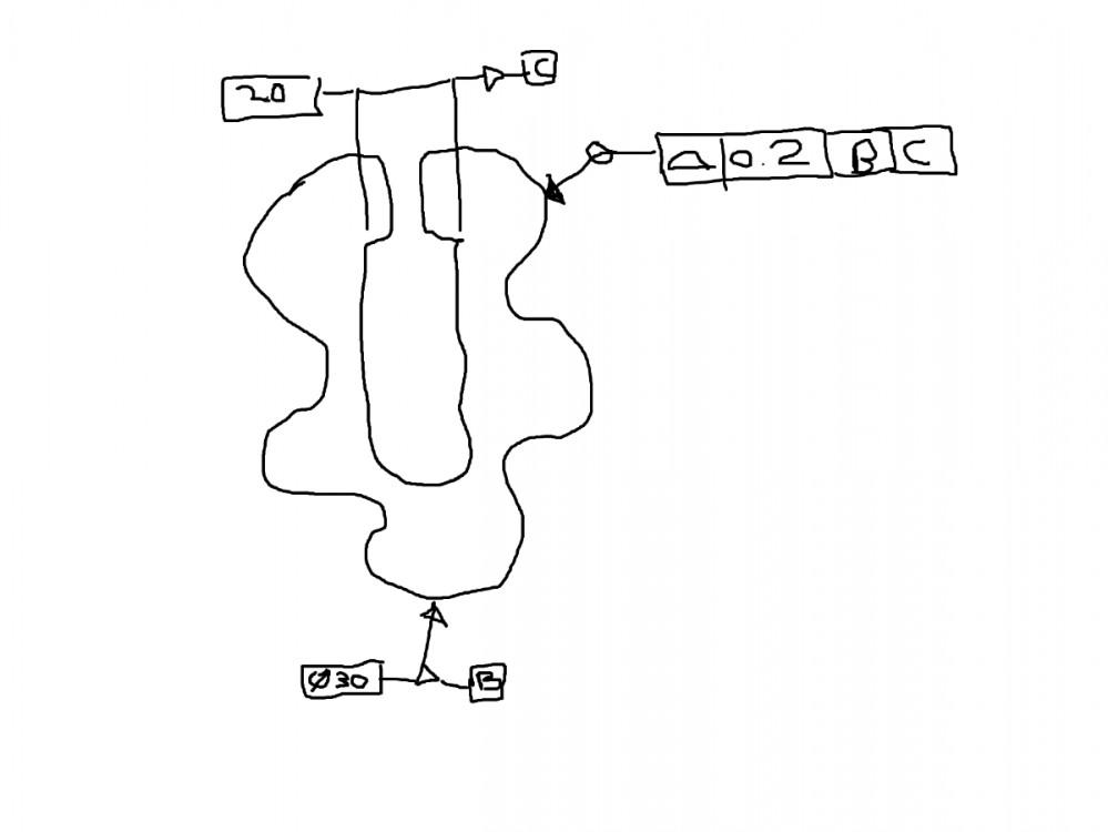

[Ed...] Posted October 20, 2025 Share Posted October 20, 2025 (edited) Hello, I am trying to measure this product. I have loaded a DXF (we don't have the STEP module (don't get me started...)), and I am trying to verify the profile as shown on the drawing. How? If I generate the features using 'Generate from CAD' and selecte 2D curve. When I measure the points it will show a very weird outline and measurements have a deviation of 4mm, where I expect it to be close to or in spec. When I overlay the camera image and the CAD model I see very little variation for example. What am I missing? The curve manual didn't offer much help neither. Please help because as always; it's urgent. * system is a O-Inspect 543. Product is too small/thin to probe. Edited October 20, 2025 Link to comment https://qualityforum.zeiss.com/topic/24803-help-optically-verifying-a-profile/ Share on other sites More sharing options...

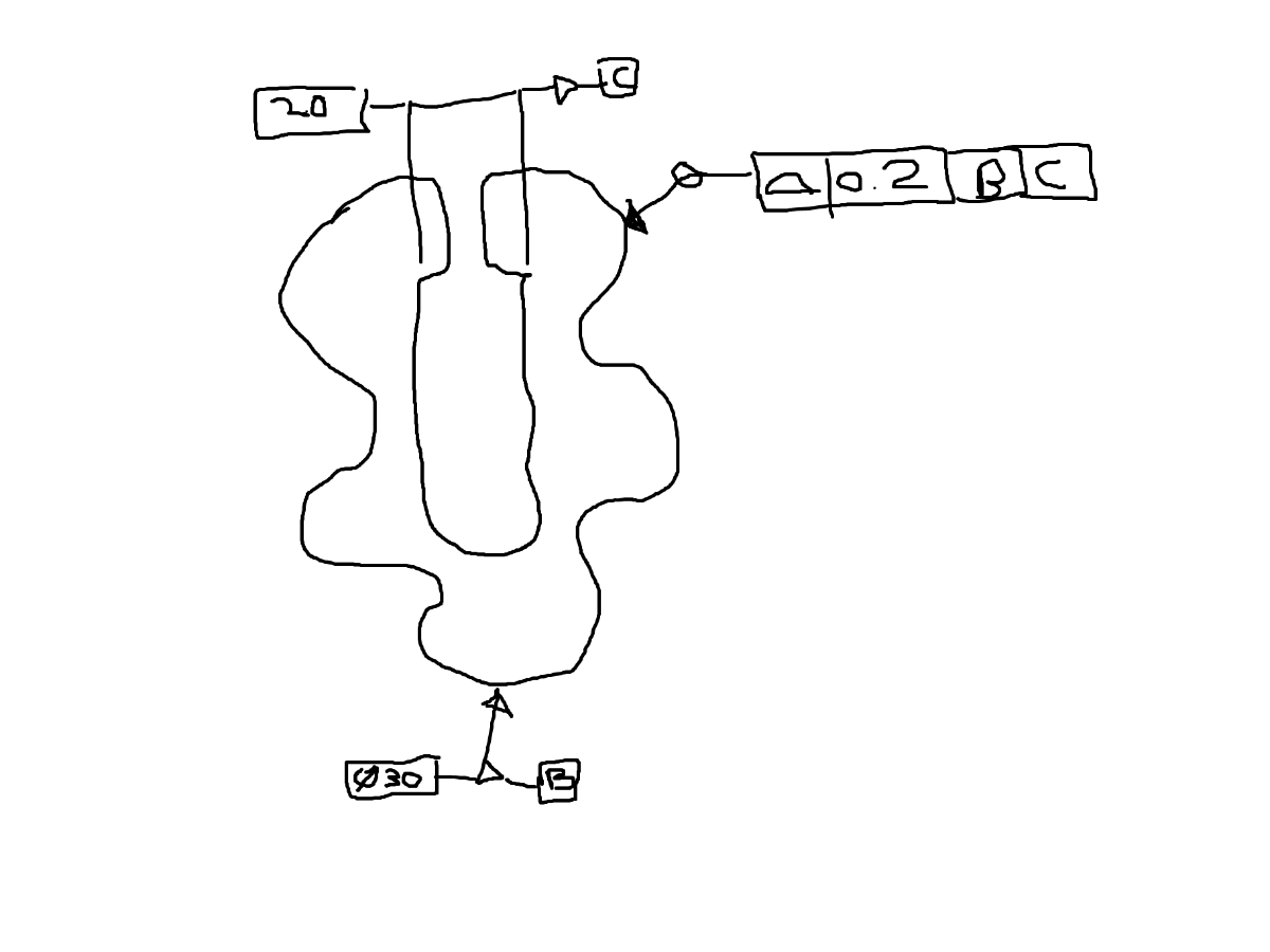

Popular Post [Ed...] Posted October 20, 2025 Author Popular Post Share Posted October 20, 2025 Also, please appreciate my beautiful artwork. 6 Link to comment https://qualityforum.zeiss.com/topic/24803-help-optically-verifying-a-profile/#findComment-140437 Share on other sites More sharing options...

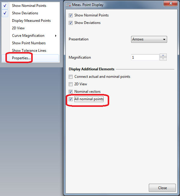

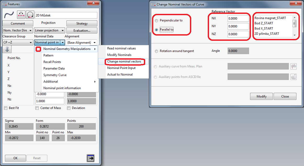

[Ma...] Posted October 20, 2025 Share Posted October 20, 2025 I think you can have problem with vectors of those points. Open that curve and on CAD view right click with mouse, open settings and select to show all nominal points. You can try to correct vectors in curve feature window to be parallel with a feature or manually selected vector. Link to comment https://qualityforum.zeiss.com/topic/24803-help-optically-verifying-a-profile/#findComment-140459 Share on other sites More sharing options...
[Ed...] Posted October 20, 2025 Author Share Posted October 20, 2025 Please sign in to view this quote. How would I go about doing this? I think this may be (part of) the issue, as sometimes the arrows point in the Z direction, while they should be pointing in X or Y ofc. Is there any easy explanation on this? Zeiss Service only says: "yeah, you should have a SMA with us or follow a training", which I somewhat understand, but I need to solve this issue rather fast. Thanks for your help Martin, always. 🙂 Link to comment https://qualityforum.zeiss.com/topic/24803-help-optically-verifying-a-profile/#findComment-140461 Share on other sites More sharing options...
[Ma...] Posted October 20, 2025 Share Posted October 20, 2025 (edited) This is for showing all nominal points: This is for modifying vectors: !!! Before modifying anything on nominals - make a copy of your feature and tryout on that copy first - i know you can use ESC key to revert changes, but sometimes people forget about it and close window by (x). You can also invert individual points by clicking on that arrow icon below "CP +Z" text to show whole list and right clicking on mouse to show context menu and select "Invert vectors" - you can also do selection of points like in windows ( Shift key to select all from initially selected point / Ctrl key to select individual points by clicking on them while presed Ctrl key ) Edited October 20, 2025 Link to comment https://qualityforum.zeiss.com/topic/24803-help-optically-verifying-a-profile/#findComment-140463 Share on other sites More sharing options...

[Ed...] Posted October 21, 2025 Author Share Posted October 21, 2025 Please sign in to view this quote. Hi Martin, I found four points that were inverted and simply deleted those. Then I got what I think is a reliable result. As for filters and outlier elimination- any good reference or baseline? I'm only used to doing this with a scanning probe, not optically. Link to comment https://qualityforum.zeiss.com/topic/24803-help-optically-verifying-a-profile/#findComment-140501 Share on other sites More sharing options...
