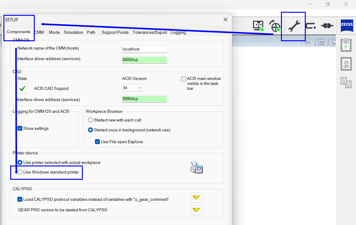

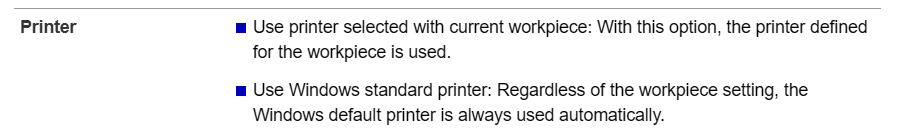

[Ro...] Posted October 21, 2025 Share Posted October 21, 2025 1 Link to comment https://qualityforum.zeiss.com/topic/24805-global-printerprinting/#findComment-140499 Share on other sites More sharing options...

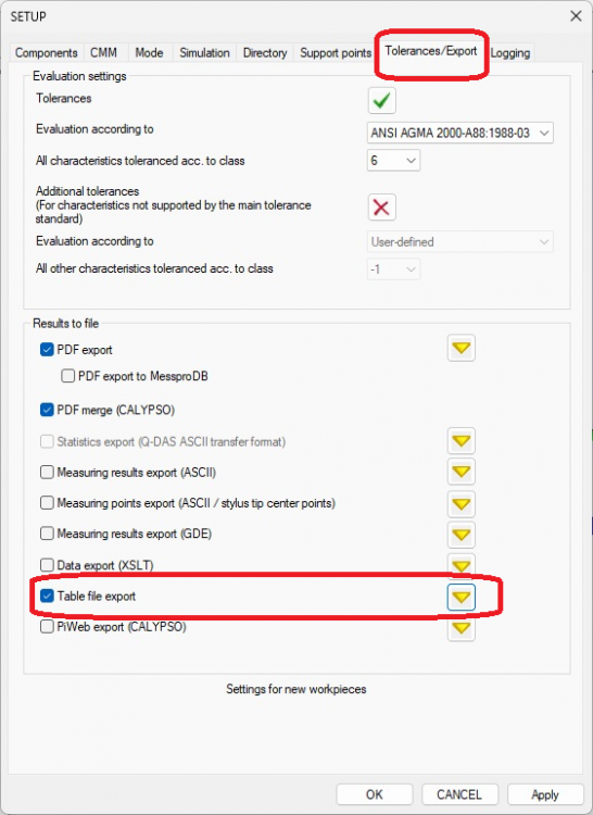

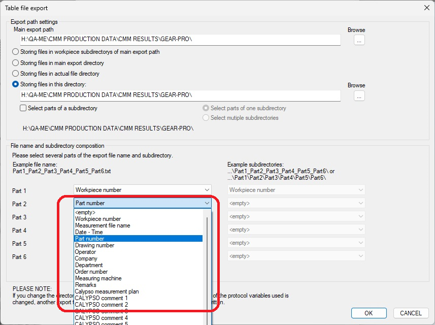

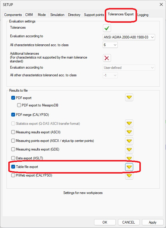

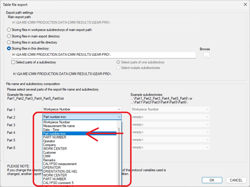

[Jo...] Posted October 21, 2025 Author Share Posted October 21, 2025 Seems like that does the job. This Setting Menu was what I was looking for. I appreciate the help. Roman, aside my initial question about the Global printer, under the same Setting Menu, I tried the "Table file export" features and in drop-down the "Part number inc." was missing from list. When I use this same export feature within the program file, it shows up there and available. If it does not show under the Global setting, how do I get that option to appear in the drop-down? Under the Setting Menu: Within a program file: Let me know if there's a way to get that in the setting menu drop-down list. Thanks. Link to comment https://qualityforum.zeiss.com/topic/24805-global-printerprinting/#findComment-140521 Share on other sites More sharing options...
[Ro...] Posted October 24, 2025 Share Posted October 24, 2025 Hi, this seems to be a small visualization bug. At the end it will do what you expect and will use "part number incremental" for the individual new workpiece even if in the setup "only" "part number" is visualized. Link to comment https://qualityforum.zeiss.com/topic/24805-global-printerprinting/#findComment-140767 Share on other sites More sharing options...
